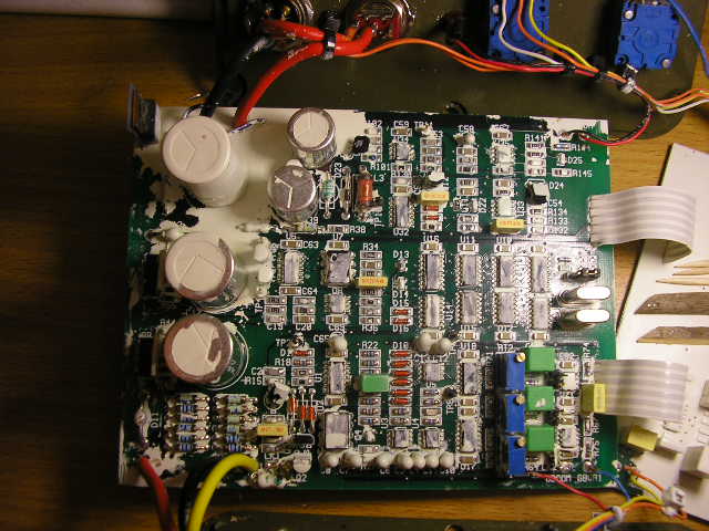

    Thought i would give modifing a go.So i purchased a Minelab SD 2000.
    Mind you i have no experence in electronics as i am a plumber,and i still dont know how to use a multimeter !

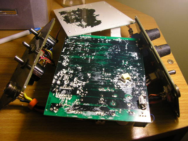

    So this is the start.Ripped the boards out of the box as you all know lots of paint,i read Woodys post on what he used to remove the paint but at the time i couldent remember.
    i had some mineral turpentine let that soak for 5min then 10 min the 1Hr and then over night and still nothing paint was hard as.
    next i tryed kerosene over night and still nothing.
    So i went out and purchased some paint stripper after 15 min of putting it on some spots started to blister.i used i plastic scraper and a hard brush to scrap the paint off ,man was it still stubben,i even left the paint stripper on over night and it was still hard to get off i ended up breaking my plastic paint scraper only broke one wire and the yellow thing on the soilder side of the board you can see in the picture.
    On the top of the board in the middle, the paint stripper took off the compents protective coating on it as you can see the copper winding.
    This happened about 2/3 weeks a go as i tend to run hot the cold.
    i guess i should do one mod at a time and test then move on to the next one.
    All i am trying to do is increase my knowlage of components, detectors,and enjoy my new hobby.

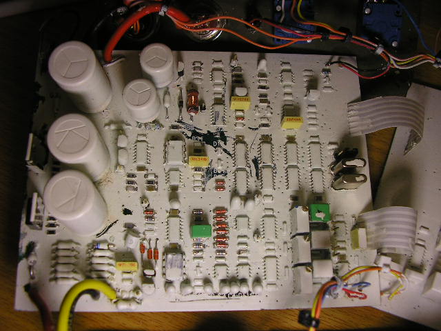

        I dont think i left the paint stripper on over night "as i stated in earlyer post" as i would not recomend doing this, as it does eat into the component parts.In the photo you will see 3 blue components next to each other as after 20 min's of paint stripper on them, the blue coating was soft and would just scrap off.
        I spent 1.5 hours removing the paint with paint stripper and some small pices of wood cut on 45 degrees and tooth picks as paint scrapers."you can see them on the right of photo"
        it does look better.
