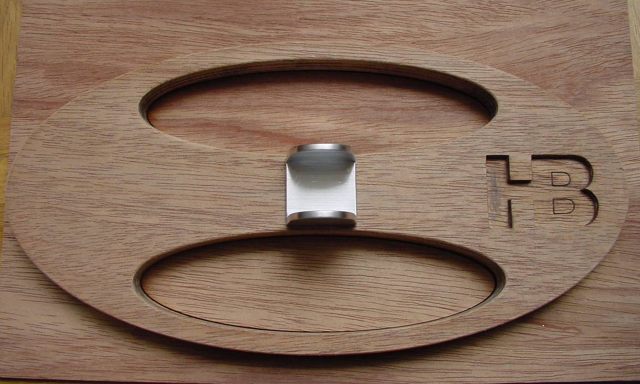

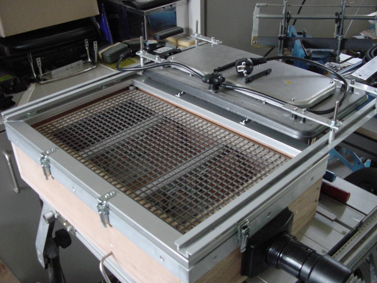

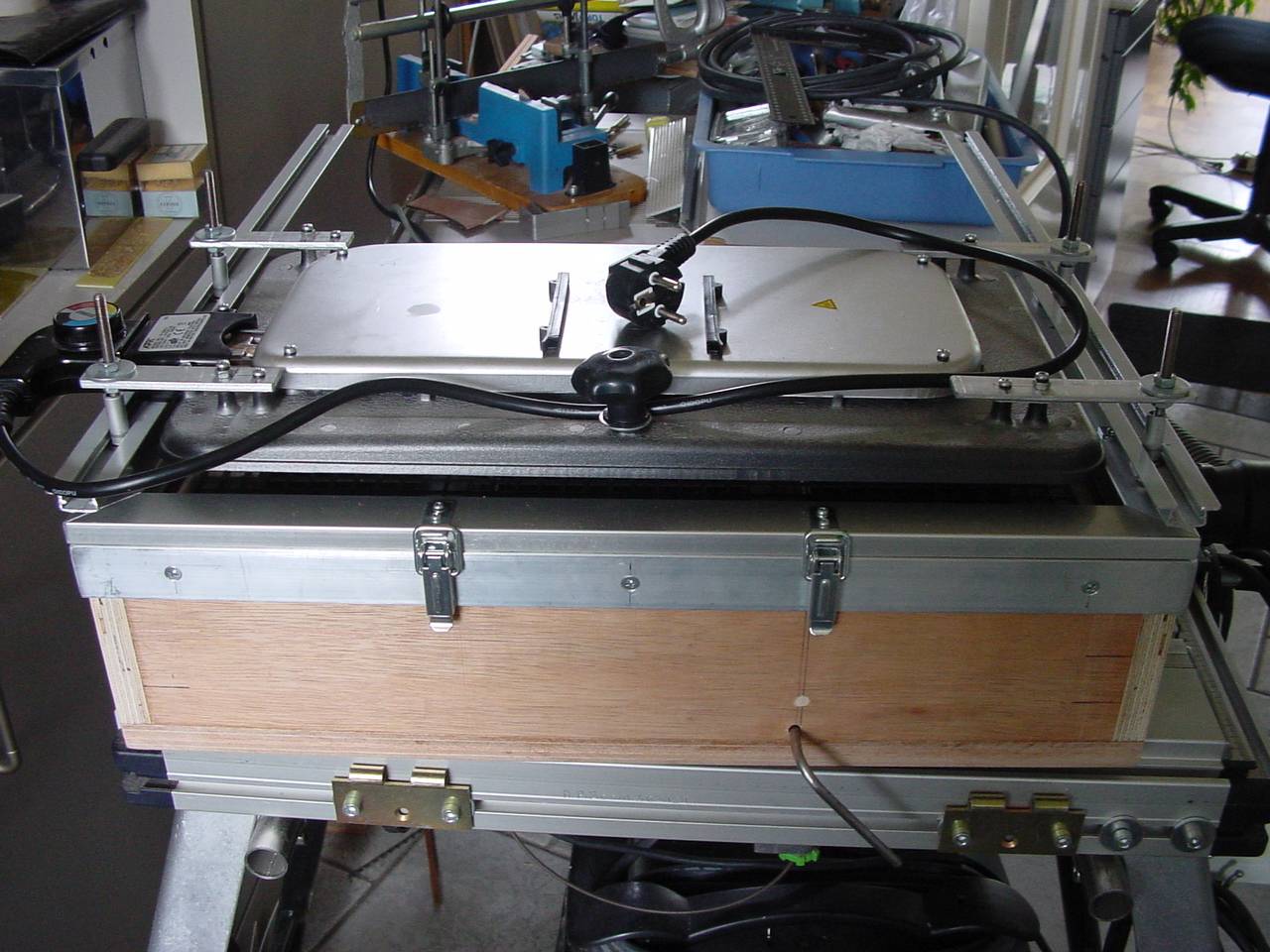

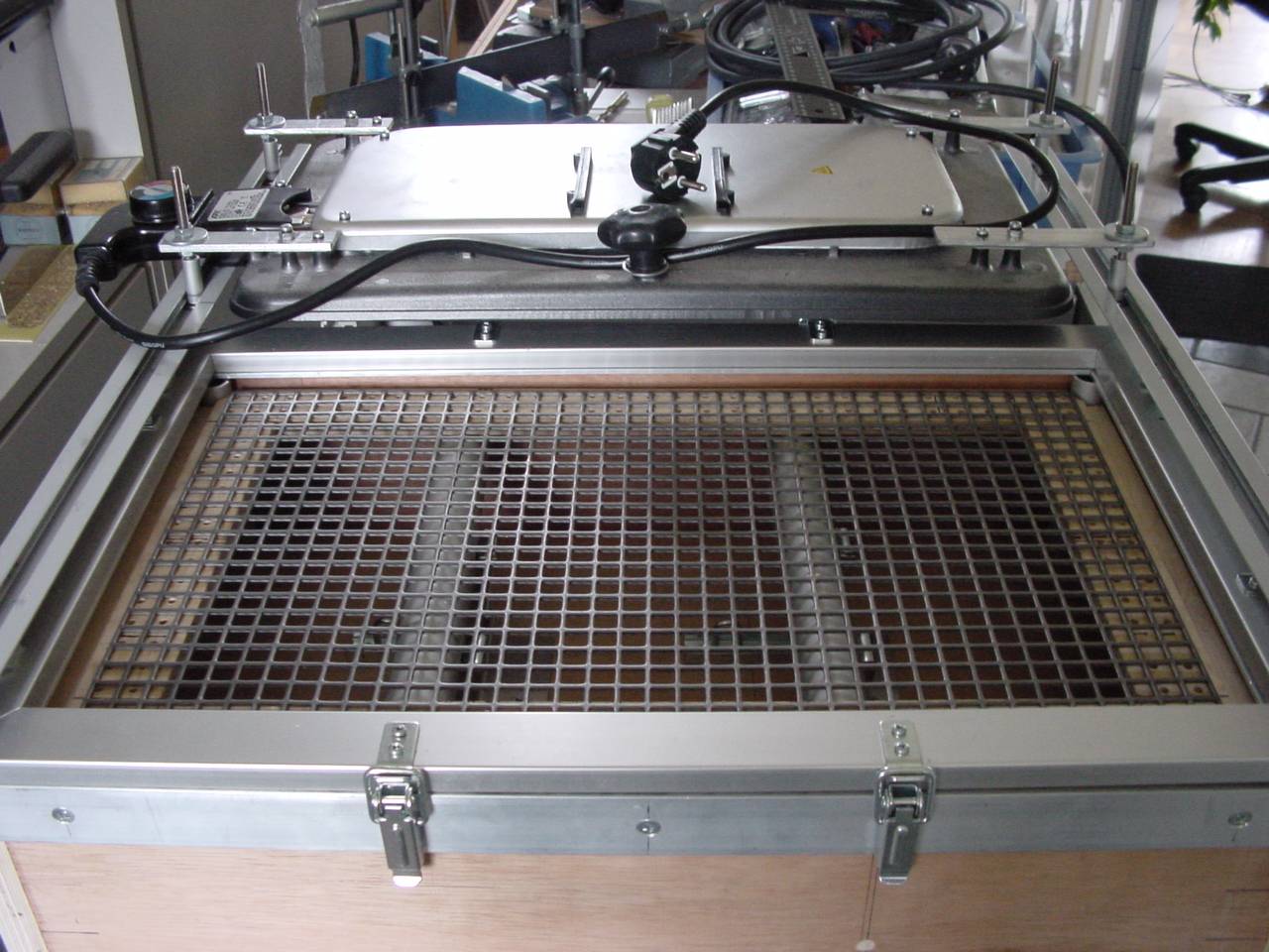

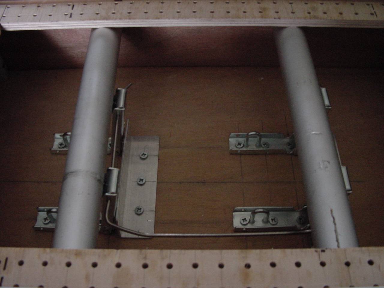

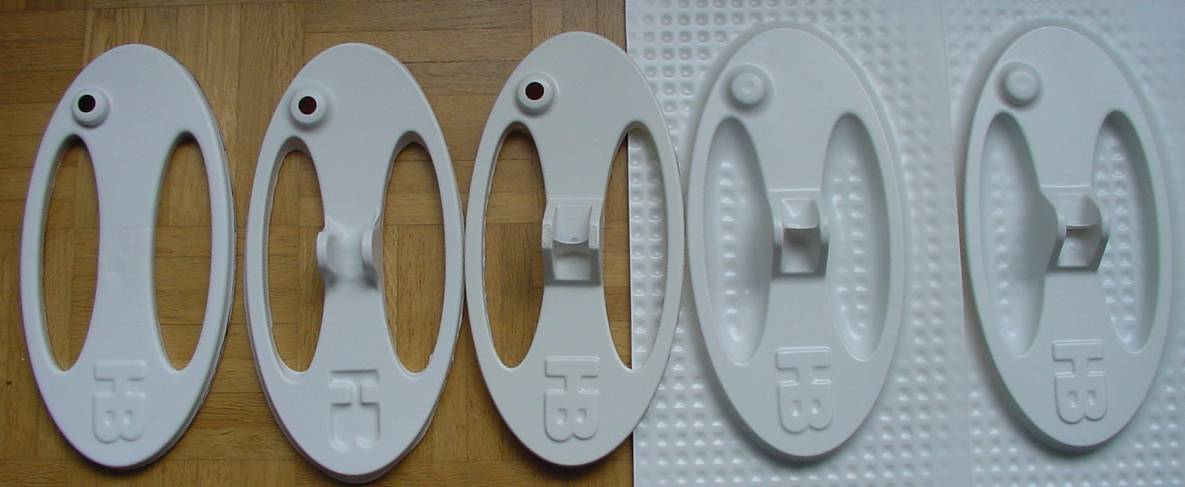

          kitchen made, and Iam still experimenting 28x14 cm.Grt Nakky.
            Hi Nakky,
            excellent work!
            This looks very professional and stable. I have to build one coil for my laptop MD soon. Could you provide us with more infos on how to build such coil housings?
            It will be appreciated very much.
            Aziz
                        Hi Aziz, i read all about vacuum forming on the internet,than I start to made my one former but it is still a experiment.Grt Nakky.

                          thanks a lot. Your coil housings are very impressive. It is sure beyond my possibilities. I put a small piece of plastic into oven. I will see what is going on. I am using only the gravity force instead of vacuum. And it seams not working perfect.
                          Well, I will make a fibre glass coil with resin. This is quite easy and with less expense.
