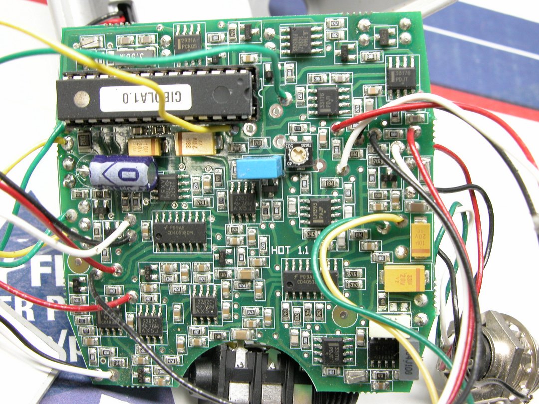

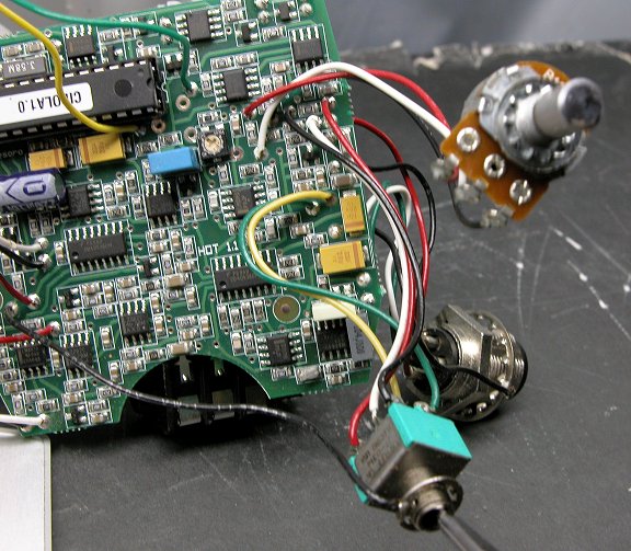

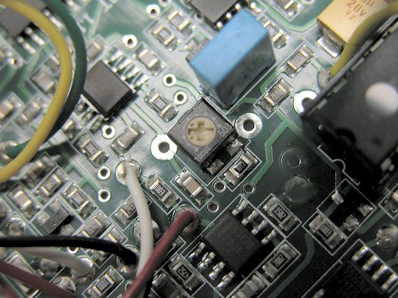

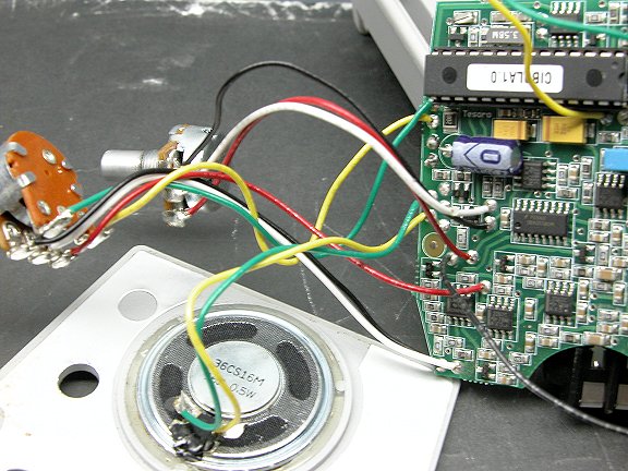

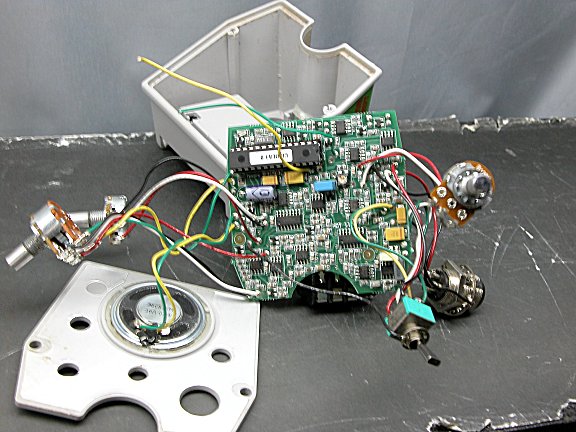

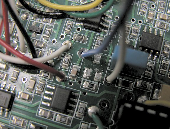

End results were excellent. Using 9x8" coil, now Air tests about 1 1/2 - 4" deeper than fixed groundbalance in all metal and gained 1- 3" in disc. mode. Meets or exceeds the air test results I got with the Tejon I owned. Hot little booger with the 5 3/4" coil, too.
I am happy with the results using the 10 turn pot for GB.

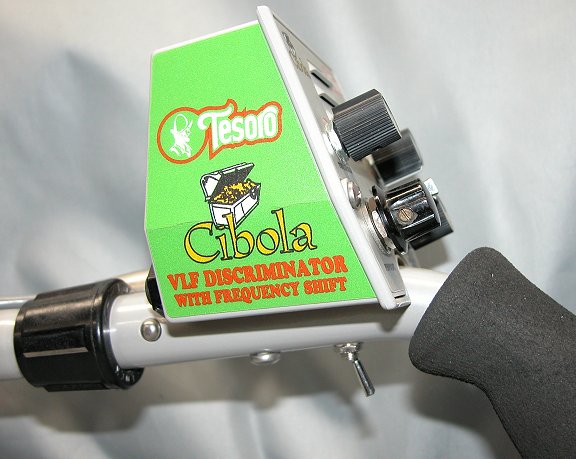

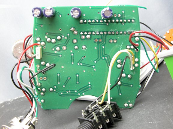

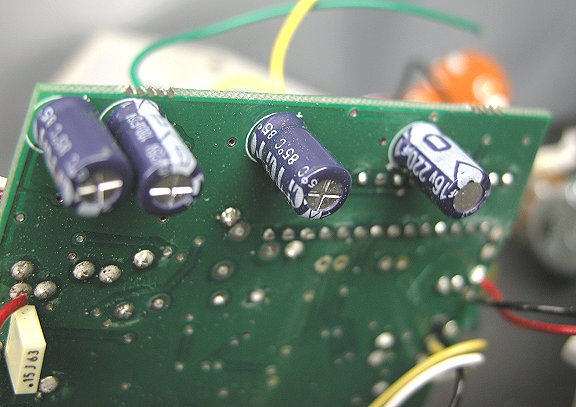

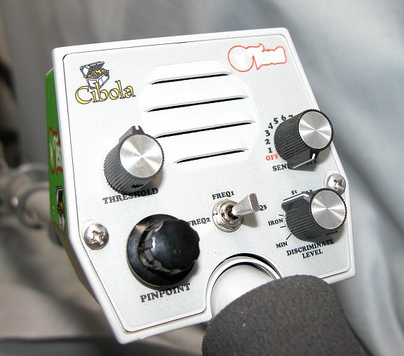

Here's some pictures, still learning with this new camera, so they are the best I can get at this point.
