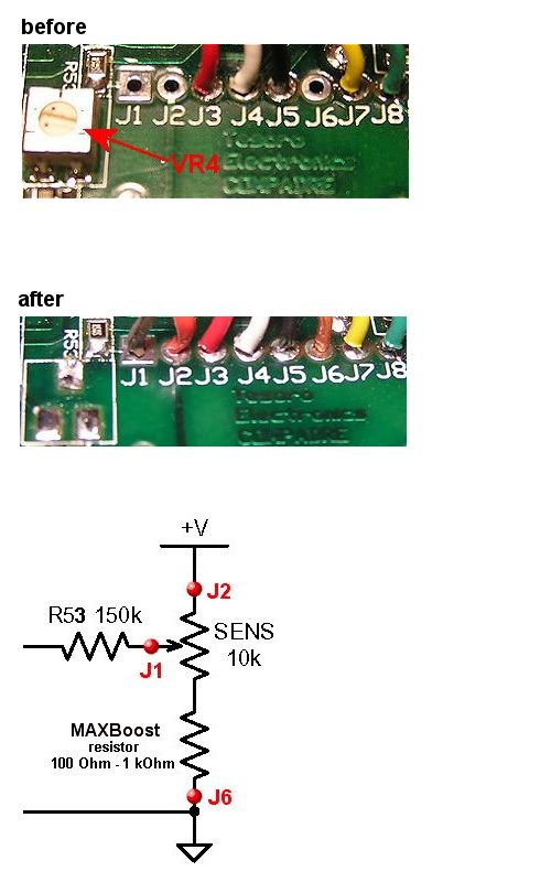

      hi, can you send photos of PCB?

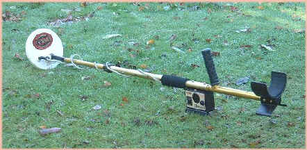

        I have the B3 Powermax too and Pulsar Electronics modded the living rocks off it for me. It's an awesome coin hunter now, 11" Polo coil, fixed / manual ground balance, drop in battery fitting, easy take-down three part stem (breaks down into a back pack).

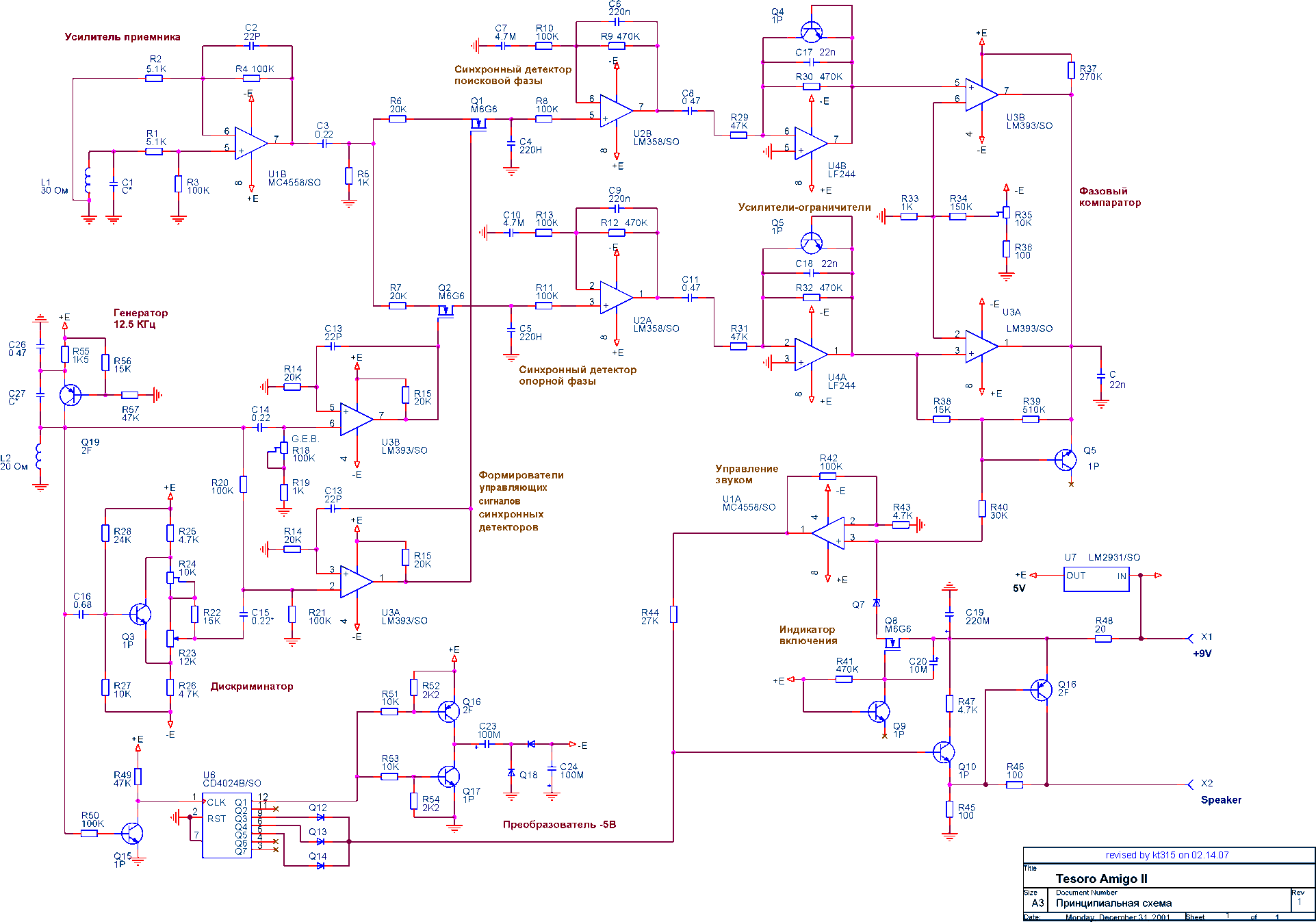

        Not much can be done with the circuit as it's built using one of Tesoros horrible and unreliable hybrids, though the retune can be altered to give it a VERY slow threshold return.
        This little lot would have cost over £200 when done by an "official" modder but cost me just over £100 to have done.
