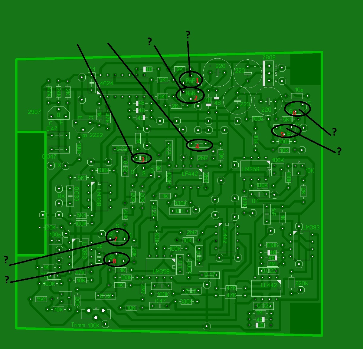

            What is the value of the number of pieces that give
            • How you think to build this, if you cannot read parts from schematic:
              http://www.geotech1.com/forums/showt...3282#post83282
              • sorry Unprocessed thats scheme...thanks WM6.
                • Wish you all success with this classic Tesoro VLF/IB diamond.
