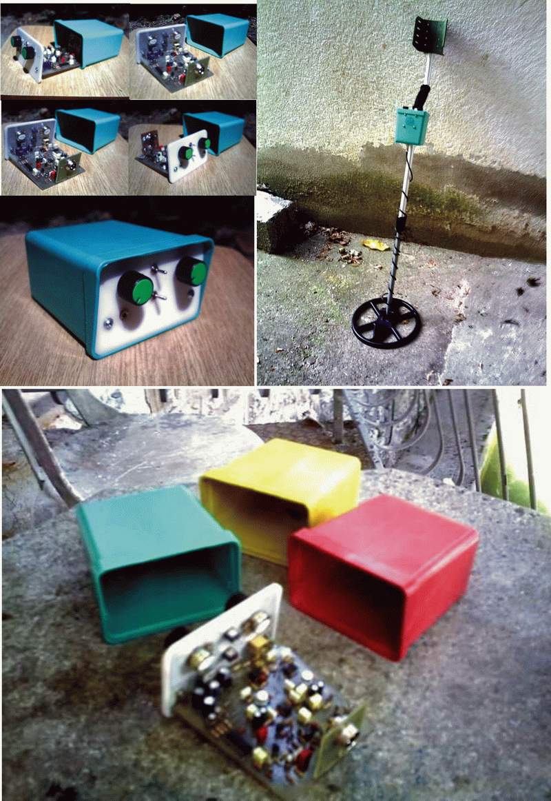

    • #62
      Huh...up from recently i also have a lot of problems to obtain that material. In the past i got enclosures and shafts from Bulgaria. Now that connection is lost. I dont know exactly who in Bulgaria is making those.
      I would like to know and establish connection again, so to order some pieces from time to time. But...searching the internet i found only this link. Guy from this link is advertising Coinseeker Pro 2 which is some copy of Relic Hawk or Musketeer...somehow reduced and modified (it's been debated about this already, in RH thread).
      So looking at those photos i spotted same enclosures and simillar shafts.
      I would like to find out who is originally making those plastic enclosures so to conntact a man.
      Here is the link:
      http://www.geocities.com/powerline_bg/index_bg/producti.html
      If you find out the right man and address, pleas let us know here.
      Regards!

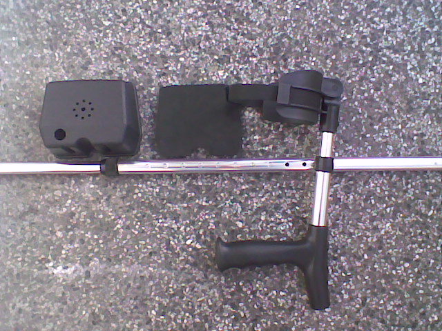

      • #63
        I will try to contact an old friend there who might help.
        And what about the shaft.I see that armrest can be adjusted.Never saw such before.
        If I find something I will post it here.
        • #64
          Yes, that photo i took from the link. I think it is very nice soluted.
          In my case... i am using whatever come to my hands!
          Sometimes i do make my own shafts, sometimes i use some originals...depends.
          On this photos you may see - i used original shaft from MD3009a (Seben also).
          Shaft is not big problem to make..but enclosure for detector and enlosure for coil is real pain...to make or to obtain. (really good enclosure..not some ordinary)

            • #66

              • #67
                Originally posted by Ultimate_Haze View Post
                I see now.
                This enclousures looks very handy.I am seaching now too.
                Soon on later we will get a link to the manifacture.
                I use ABS plastic enclousures for coil.But I have saw some fibreglass+epoxy.
                Which one is better according to your excperiance?
                This Eldorado is eching me more and more.I will go now buy the rest of the parts I need.
                Both are good if you use later some hi quality and cold dry filling mass. I have expereinces with both materials, both are good.

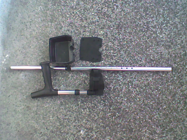

                • #68
                  Can you show the cable you use to conect the coil and the device?
                  This are MD enclousures that I can find.
                  Also you see the materials to make a shaft like on that picture you posted.
                  Tomorrow I will bend,paint and show my way!But you see similariyes I am shore.
                  If you are interested in MD enclousures they are like some seben and some MD....just let me now.
                  What is this mass that you fill with?Can you give a link?
                  • #69
                    Is it "Golden Mask" ? Looks like. Anyway...i like that enclosure. Of course i should draw quite another pcb for it, but it will not be a problem, easy for me.
                    About shaft... lower part is excellent and i like it. Upper part i dont like. I prefer uppper part to have "lazy S" bend like on my photos...
                    Or even better to have small, angled handhold like original Fisher 1265.
                    But it is never mind, it is just a detail in overall story.
                    If i could obtain ...let's say at least 5 pieces of those enclosures than i will draw another pcb to suit exact inner dimensions of that enclosure.
                    What should be the price?
                    Mass....hmmm i already tried to explain on TGS thread in the past. It is local product (but i guess in every country has it also by other name). It is the same mass as in HV transformers for tv's. 2 component, once you join them it is drying cold and has no relative movements. When dry after 10 hours it is solid as a steel! Not possiblle to break it at all....Once you fill coil enclosure with it - the end! End of a story... perfect!
                    • #70
                      I awso like "S"shape.I just wanned you to see the armrest that is exacly the same as on the picture you posted.I will go tommorow to bend the lower in "S"shape and then transfere the armrest again.And we have excelent MD shaft.You will see.
