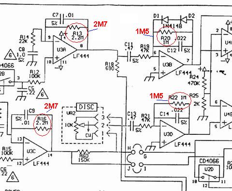

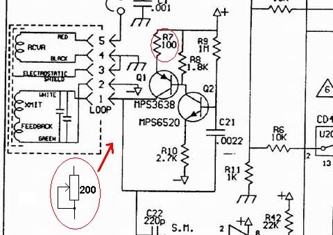

Hello all,
I'm looking for some easy to do modifications for my old White Classic 1 metal detector. What are the different kind of mods out there? I'm mainly interested in increasing the search depth of the detector.
I don't have a lot of experience in soldering, but easy things such as changing some resistors shouldn't be a problem. So what can I do myself?
