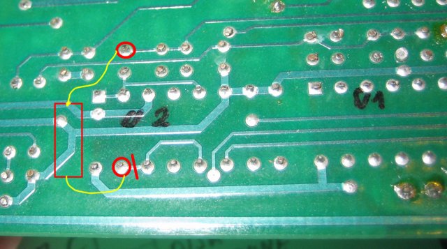

      what do you think about of this mod?
      Here is a 4-Tone Audio ID Mod for the Fisher Quicksilver CZ-7a, CZ-6a and CZ-5a. (Without the mod it only has a 3 tone audio id). You only need to attach a 680 kOhm Resistor at the places indicated and cut off the connection between Pin 14 and 15.

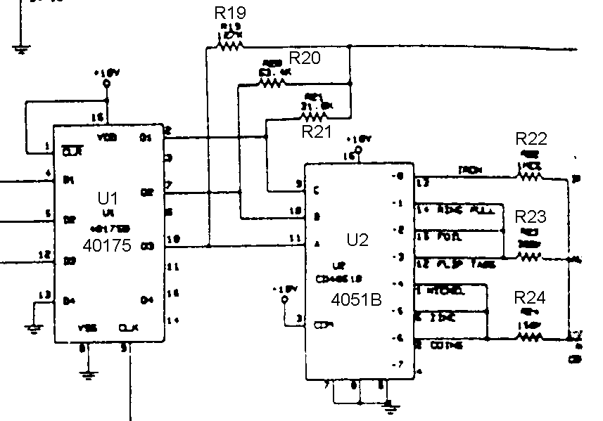

        Now...that is very interesting. But without partial schematic which can explain that, i am really not able to understand what you have done there. Dont have any CZ7 right now with me to see. It would be good if you can trace that part and draw part of schematic, where it could be cleary seen what was done. Thanks in advance!
          no need to draw part of schematic... only digitally shoot back side of PCB in mod's place, the side of components. the schematic we have of, it is clear to draw what there the resistor does.
          hh
            U1 - 40175, U2 - 4051

                    hello Apocalypse Now, sorry I did not the mod. the photos are keeping from CZ-5 repair time I did. I only try catch a person's meaning... what the trick does ... I see the mod is really in tone control circuit going VCO...
                    schematic
                    http://rapidshare.de/files/47692047/Fisher_CZ5.zip.html
                      may be you able to de-code these blur abbreviations of U2 pins? my english is so poor... not for tonight romance singing...

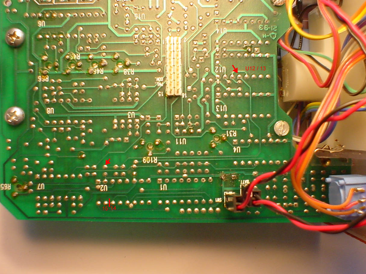

                          If you have additional information that can help me.
                          Thank you.
                            These are photos of the fisher cz 7a pro.
                            Are different from cz6.
                              Apocalypse Now, may be you have CZ-70 PRO, not CZ-7?
