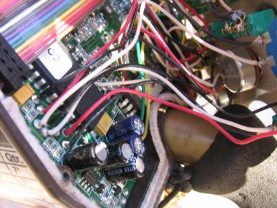

    on other forums these pictures got posted how easy would it be to add gb in am mode for the deleon
    the first photo is of a cortes the second my hawkeye(deleon)
    bye the way on my hawkeye pcb it says cortes rev2
    also on the pcb to the left of the board it has 4 vacant holes anybody know what they are for

      I fairly certain the Laser Hawkeye is a simplified Cortes, not a DeLeon.
      Both the Cortes and the Hawkeye have 9-segment displays, whereas the DeLeon has a 5-segment.

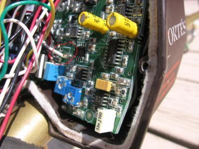

        it has been confirmed from person who posted photos of cortes the wires do go to the gb pot ill order one from farnell 10 turn i think and try it out

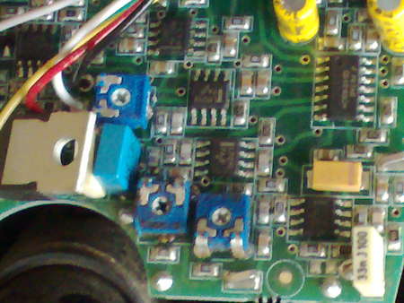

        anybody else got photo of the inside of there cortes (left side) so i can see were the vacant holes on my pcb (hawkeye ) go to

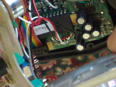

          deleon(hawkeye)
          need some one to trace wire on there cortes
          first photo my hawkeye
          second cortes
          do all these wires mean i could add sum mode or notch to my hawkeye
