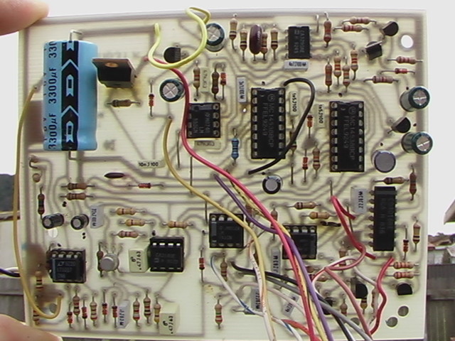

    I cant find these parts to replace for my XL 500 i am trying to fix desperately ..can somebody please help me with other parts I can replace them with ...
    the parts numbers are...
    CA3140E
    LT1037
    CD4016BE
    NSDU45 (8611)
    If you can help I will greatly appreciate it Thank you guys

    I don't want to lecture you but you're not supposed to just start replacing every component you can find a replacement for. That is not generally accepted as a smart troubleshooting technique.
    If you beg, borrow,- or steal an oscilloscope, they are not that difficult to use. Don't break your machine any more.
    Stop it, Stop IT, STOP IT STOPIT STOPPIT, PLEEEASE! STOP.
    Hmmm, it occurs to me: if you get the XL500 working again - after all the major parts have been replaced it would probably be due a timing and voltage offset calibration. Have you planned on that? Don't expect to blindly turn potentiometer screws and get lucky. Is there a repair shop handy?

        I would be killing you with kindness to tell you this but the damage is already done so...
        if you can't find the first three parts you are looking in the wrong places. The CA3140 is an old, OLD part, (almost as old as me ) but is still listed at Digikey (and many other places), as are the next two parts. I don't have a clue what your NSDU45 is or what it does.
        Digikey ships pretty much world-wide.
        The LT1037 is your preamp. If you replace that, I believe you would need to do a receiver offset voltage calibration. I can't tell you the proper procedure and, you probably do not have the proper equipment. Do not replace the LT1037 unless you know for sure that it is defective. Else, you might have two problems - if you don't already.
        The CD4066 is probably safe to replace with no adjustment needed.
        I think CD4066 break fairly often so if you are hell-bent on replacing parts that would be a good start. You could also probably replace the CA3140 with no re-calibration needed.
        You must be particularly careful with handling the CD4016 and CA3140 because they are CMOS devices and easily zapped.
        The suffixes after the main body of a part number generally USUALLY indicate temperature grade, and package (DIP-8, DIP-16, etc.). The CDxxxx series parts also use a "B" to indicate that they have "Buffered" outputs. That seems a little unnecessary to me because I have never seen an unbuffered CD4016, but, who knows... .
        The point of that last paragraph is that different manufacturers will use different suffix letters to indicate the same parameters, i.e., one manufacturer might uses "N" and another use "P" to indicate DIP-8, and etc. etc.. It is usually OK to deviate from the original manufacturer when you replace parts (so long as you cross-check datasheet) but it is also generally a good idea to have the proper TEST EQUIPMENT before you start replacing critical components.
        It is good to see "BEFORE" and "AFTER" waveforms and voltages so that you can know that you fixing the problem better instead of making it worse.
        edit: The "8611" on your NSDU45 (whatever that is) is probably a date code and is extraneous information when looking for a replacement.
