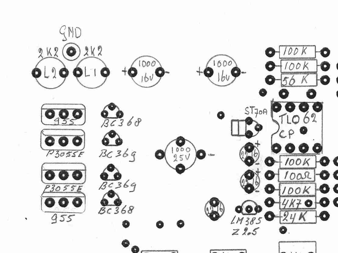

    Finally my friend gave back my Sovereign XS. But with problem.
    When i turn on it detect with medium depth for 10... 15 sec and after it it lose the audio and the depth. I must touch a coin on the coil to beep.
    I opened it and measured the power supply. I read the +-5V as 9.7v (the leads between the +-5V) but when begin to lose the audio it run until 10.8V. I have a schematic of Power supply but i need a schematic for all the detector if problem is not only the P.Supply.

            Still problem with power supply. It use a TL062, a BS170 and a KA336-25. I replace the TL062 but nothing. I did not found BS170 so i connected a BSS108. Problem exists. Ka or LM336... i did not found them , so i replaced it with a 2.5V zener. Nothing .

              Geo you can use,
              BS 170 = ST 70A if jou can find
              LM 336 = LM 385 Z 2.5 are the numbers in my SOV XS
                Geo,I think the only problem is the BS 170 start with this.
                Grt Nakky.
                  Geo,is it this part of the pcb ?

                    The pcb is not the same. Today i will give it again a try. Also i must replace the two capacitors 1000uF/16. If one of the two is not good then it moves the gnd point. Finally i will make a simple external power supply . Anyway, i will go for 2 days at a mountain for treasure hunting with a big team, and when i come back i will continue....

                        Hi. Finally i repaired my XS. I replaced TL062, LM385 and BS170. Voltage was 10V but the ground was not good, it was 0,+7v,-3V. Finally i found a burned smd transistor, i replaced it and now is OK. But how this transistor work??? it is connected the collector to -5v, the emitter to gnd and the base to the output of a quad op.ampl (TLC27L4). This tsansistor was short (small resistance) so it moved the gnd point. But who is the purpose of this transistor??? to protect from what??? i really don't understand.
