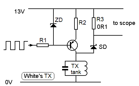

    The purpose of the modification is to suppress parasitic AM of TX when the height of sensing head above conductive ground changes.
    The new element is a Schottky diode SD. Resistor R3 is only required during setup.
    For setup, TX coil is placed above salt water. The resistance of R2 is reduced untill SD start to conduct short current pulses. This is energy that returns to the supply rails, but not to overdo because it appeared harmonic frequencies in the TX spectrum.

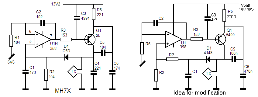

      Component values and waveform amplitudes would have helped to understand the circuit. The circuit on its own is quite meaningless, as is the unqualified term 'parasitic AM of TX'.
        Parasitic amplitude modulation of TX
        If you connect an AC voltmeter across TX coil, you'll notice that when TX coil is close to the conductive ground, the amplitude of oscillation decreased. This amplitude modulation is parasitic, because ground absorbs energy from LC tank circuit.
        The TX transistor operates as current pump, charging LC tank with energy. White's uses the worst circuit diagram for TX, because each current pulse contains stabile portion energy. When the height of sensing head above conductive ground changes, the amplitude of oscillation in TX tank modulates.

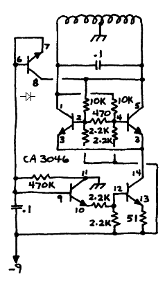

        To avoid this are used amplitude stabilizers for TX (see attached TX circuit of Fisher 440). Garrett uses P-I controller for amplitude stabilisation. I posted several TX circuit diagrams of Garrett in this section.

        In the modification, current pump carges tank circuit with a large portion of energy. Thus the LC tank overflowing. Indeed, excess energy is returned to the supply rails. When the TX coil is close to the conductive ground, the excess energy becomes less and supply rails receive less energy returned.
        Return of energy to the supply rails is not the best solution to the problem of "amplitude dismodulation". I tried to find the best solution, and since experimented circuit works very well prepared for it publication of the Forum.

            This is not so. The circuit is that of an oscillator whose amplitude is controlled by negative feedback – as in normal practice. When the amplitude reaches a predetermined level, feedback reduces the forward bias of the cross-coupled pair (and hence the gain of the oscillator) to prevent any further increase. Excess energy is not returned to the supply rails because there was never any excess to start with.
            You have introduced a new word ‘dismodulation’. I have never heard of it!

                  Pebe, before modification and after modification, the transistor operates as current pump. This is not oscillator circuit, but an amplifier class C. It transforms the input voltage (square wave) in current pulses with duty cycle 50%. The current of pulse is determined by expression Ic=(Vz-0.6)/R2. The LC tank circuit transforms current pulses in oscillation.
                  Energy return in original circuit is possible via collector junction of transistor and ZD, however this requires voltage excess 1.2V. The SD reduces this excess to 0.4V only.
                  What you say for oscillator, refers to TX circuit diagram of Fisher 440 in posting # 4. The task of "feedback" in this circuit is to dismodulate the amplitude of oscillation. For this purpose a transistor is connected as diode and operates as amplitude detector. It generates control signal for amplitude dismodulation. The dismodulator is P (proportional) controller. Garrett uses P-I controller, but for best results it should be P-I-D controller.

                    I suggested you put component values on your first circuit. Instead, you ignored my suggestion and came up with a second circuit. So I assumed you comments referred to that and I replied accordingly. But now it seems you are commenting on the first one. And now your last post shows yet another, different, circuit!
                    Why don’t you number your circuits and refer to their numbers when making comments? That way, we would both know we are talking about the same thing.

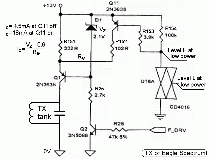

                              Pebe, below is the worst working TX circuit with driven output stage used by a great company. Output stage operates as class C amplifier with current limit by equivalent emitter resistance Re. It pumps tank circuit with current pulses, which are independent from energy absorbtion in ground. Pumping TX tank with calibrated current pulses causes parasitic modulation of TX field when sensig head moves. Spectrum of modulating signal are frequencies from 0,1 to 6Hz. The same spectrum occupates modulating signal of the target, so you need to remove the parasitic modulation if you want to find deeper targets.
                              Pebe, I use one term expressing the removal of parasitic modulation. If you do not like "dismodulation", then offer some other.
                              Now you know a simple method to suppress parasitic modulation at mode Hi Power, when Q11 is on. Put a Shottky diode and adjust tank to overflow to supply rails when sensing head is over salty water.
                              However in mode Low Power, when Q11 is off, we can not use the supply rails as amplitude limiter because the amplitude should be lower than rails voltage. But you know a complicated metod for removal of parasitic modulation - the PID controller.
