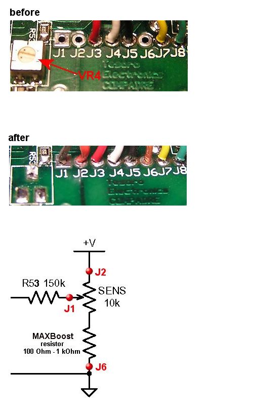

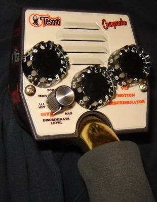

          Thanks Stefy!! I have read about the ground mod a couple of places and the Sensitivity and maxboost mod. If I do the mods I prefer them to look factory. Does anyone know where to get the knobs that are used on the compadre. I saw some at digikey that look similar. Also, what type of pot do I need for the ground mod( how many turns)? I think some detectors use like 3 turns. I am pretty confident the sensivity mod would be very easy since there are already point to solder in the pot, but what points would you attach the front panel ground adjustment on the board? I hate to sound stupid but I really would like know have the info from someone who has done it before and knows how to make it work. Maybe you could tell me stefy?
            http://www.geotech1.com/forums/showt...e+modification

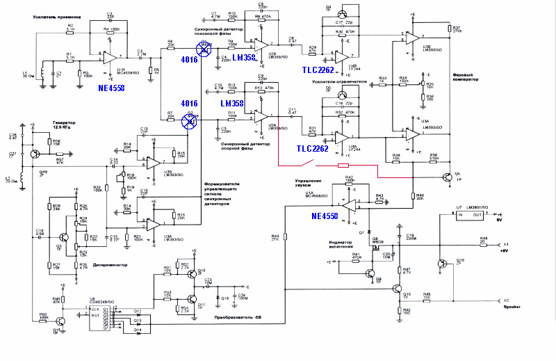

            I remember about Pepso info on Compadre mod... here is his diagramm, I do not right believe it is related to the ground balance -?

                i installed sens pot and volume pot and think it´s all what must be done to this tiny machine

                      lets talk about the tone mod
                      how is it made, sheme above is not good enough cant see all facts there
                      is it only done by add a switch or are some components removed or some tracks cutted
