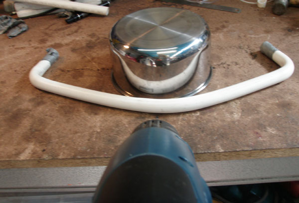

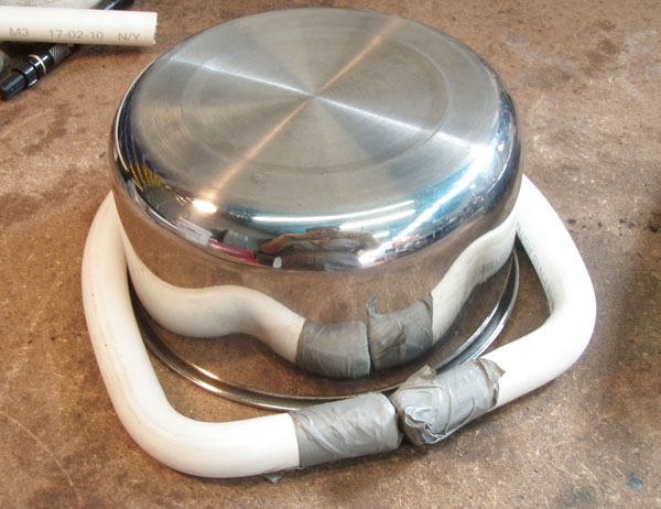

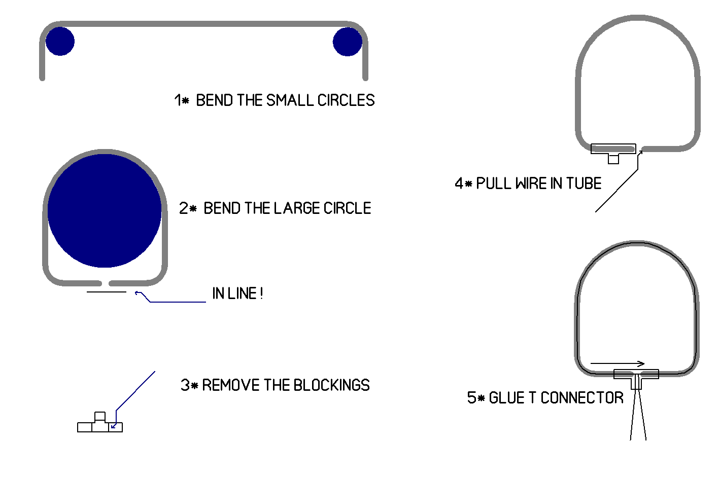

Bending from PVC tube can be done by filling the tube with fine dry sand.
The sand needs to be very solid in the tube, the ends can be closed by some tape . If you now take a electric paint stripper and carefully heat the tube you will see that when hot enough you can bend the tube very easy around a round form. Use some gloves !!

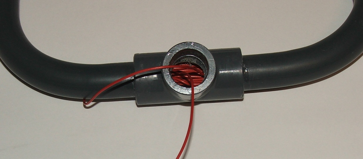

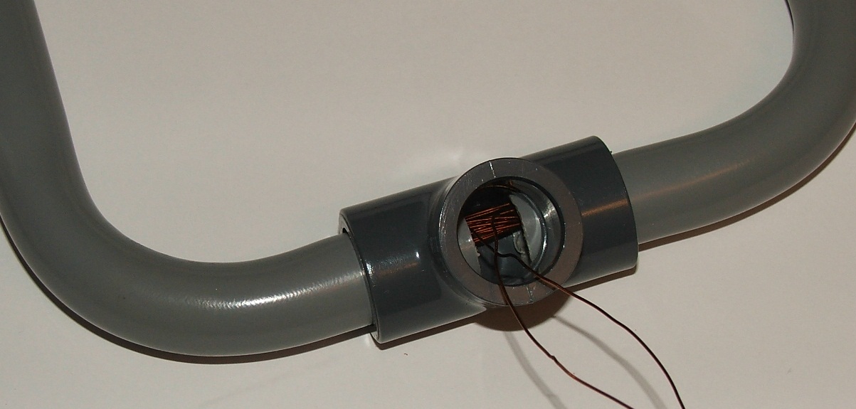

The copper wire can be pulled through the tube with the use off a thick nylon wire. I use a coax cable, stripped from outside isolation and screen wire .
I can make some photo's if you like.. (in the weekend)
Best regards.
Ap

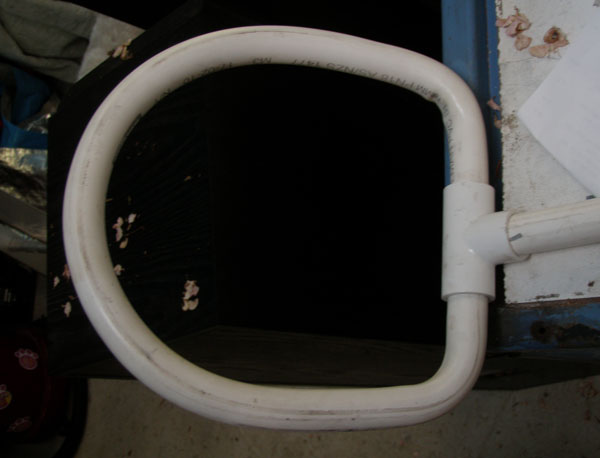

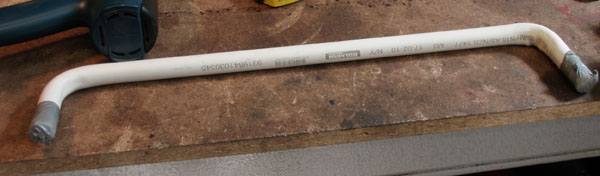

Hello Ant,

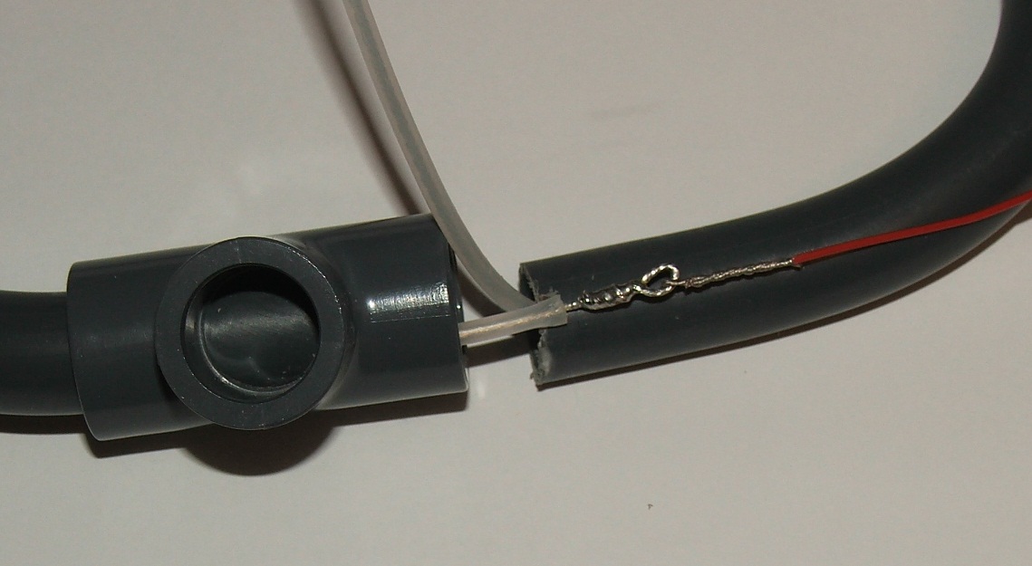

Best regards.
Ap
