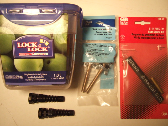

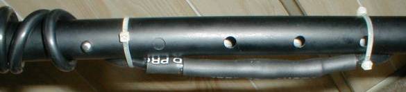

    here is an answer.
    They call it a butt splice kit, they run about 9.95 at low's or home depot, and you get a heat shirnk Gun , take you end off the cable and slide theses over the bad spots and heat shirnk it on, thier's only one to a package so measure how many you need and when you shrink them on it won't leak or nothing. here are some pictures of the kit on the right in the red container and my patch work.

      Harold,
      Where did you get the strain reliefs from? I have been making my own but have been looking for ones like you have pictured.
      Thanks!
      Don
        http://www.tme.eu/es/katalog/artykul...6page%3D2%2C20
        you mean this?
          i use self self amalgam tape for repairing things like this cheap and strong
