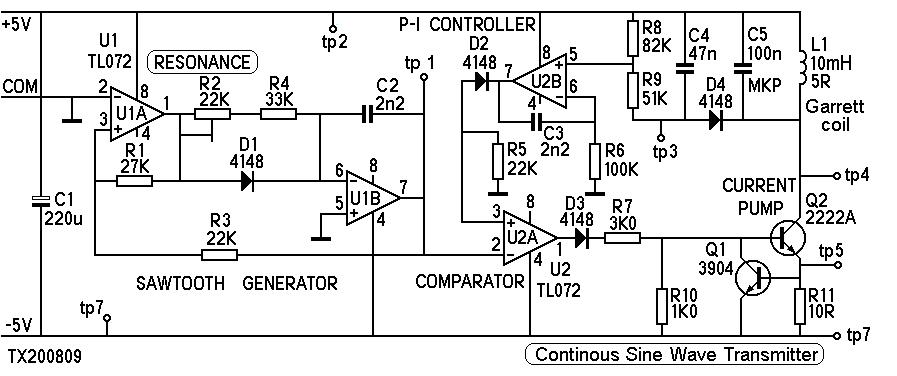

      Derick, the Spectrum XLT has well operating circuit diagram designed by Mark Rowan. Only TX section can be improved because operates with wrong principle. However such wrong principle is used also in newest designs. I made improvement of TX circuit diagram for CW metal detectors using P-I controller. However my design was for other project. It is not applicable direct for improvement of White's circuits, because use as current pump NPN bipolar transistor or MOSFET. It should be redesigned because in White's models is used current pump with PNP type BJT.

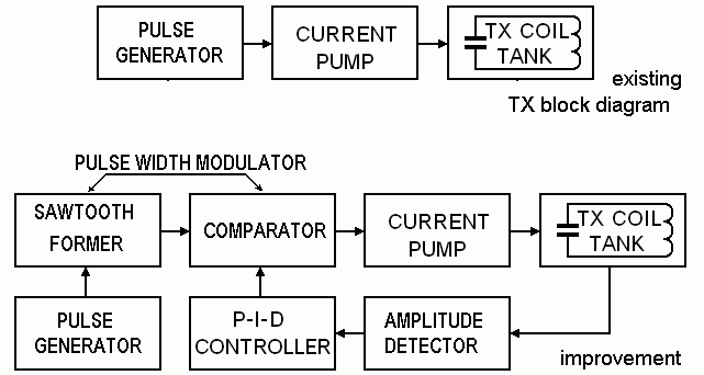

          Derick, take the breadboard. We will design and test a circuit diagram according the following block diagram.
            Any circuit mods or upgrades are no problem,but desing circuit diagram by myself is complicated for me.Principal schematics is nice,but can you desing a practical diagram?
              Let we see what is given for solution of design problem. (not "desing" :-)

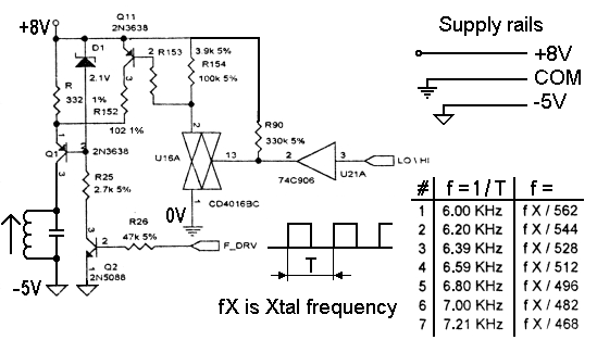

              Given is the circuit diagram of TX shown below. The operator can select from 7 operating frequencies given in table. Preferable is frequency #4. The circuit operates at two power levels: HIGH (at saturated Q11) and LOW. At LOW level is increased TX modulation index caused by change of coil height above conducting soil.
              Given are three supply rails: +8V, COM (GND) and -5V.
              We know also coil parameters and capacitance of TX tank circuit.
              The driving signal needs enough high load resistance, for example 47K (see R26).

                  Derick, this is not the circuit of mod.
                  This is the existing circuit diagram of TX in your XLT that should be improved. The whole circuit diagram has name "Eagle" in the file with following link

                      But you're not alone. Participants in this forum and I will help you. Furthermore, we have a model to copy; the attached here circuit diagram operates almost according block diagram shown in posting #5.

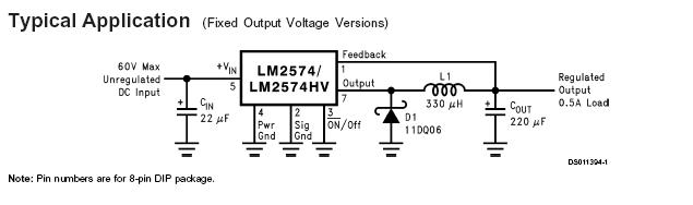

                        guys, what your thought about step up converter in xlt? DIP-8 pin-in-pin 0,5A output current do you see around?

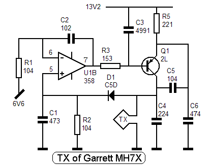

                          Anatoly, if the circuit diagram of Garrett given below belongs to your wild jungle, I will describe how it operates. I simply copy parts from well operating designs to realize the best operating block diagram.
                          My TX circuit (and TX of Garrett) improves GND elimination because dismodulates AIR signal.
                          What will improve your step-up converter? The AIR signal will remain modulated with the same frequency as GND signal when the height of coil changes.

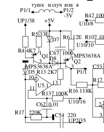

                              Hallo,
