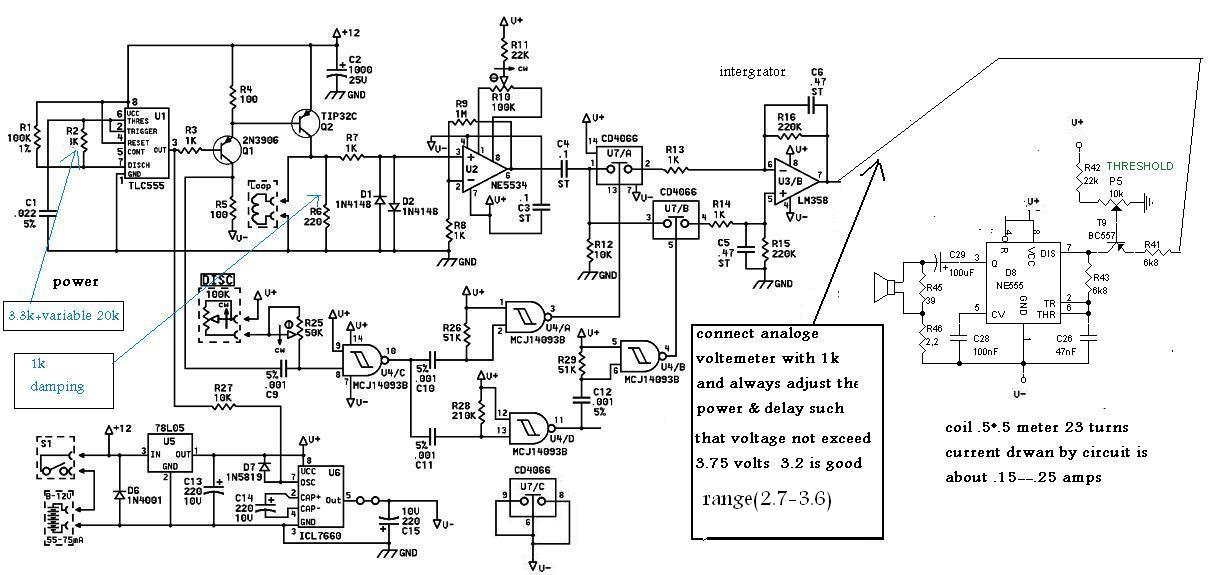

    i try to use surf master with coil .5 m * .5 m coil
    it work and detect paint can about 1.5 meter in air
    1-put variable resistor 20 k in series with 3.3 k in transmitter circuit
    Measure current draw by the circuit is should be around .2 amp
    You have to use 12 volts (4 amp lead acid battery)
    With coil 23 turns and .5*.5 m
    Damping resistor 1K
    And in the last stage
    That is the out put of integrator
    Pin 7 of L358 opamp
    Connect audio VCO circuit (copy it from delta pulse schematic)
    It work very stable and sound like delta pulse
    Very sensitive
    Important note: it is better to connect analogue meter with 1k to pin 7 of LM357 to make sure that its working in active region
    Say 3.6 volts
    I will post full schematic next time
    I need help about coil shielding

        hello every one
        i will accept any idea
        surf master is stable device and simpler than others
        my idea is why not to use it for deep seeking
        by use larger coil and more TX power
        the Vco audio circuit is better than move detection in original surfmaster
        for large coil becuase in large coil you cannot move as fast as need
        when i try this modification it is faster than delta pulse

                    Probably you will be not especially satisfied. SM-PI is designed to the detection of small objects which can be found on the beach. If in spite of all you want to experiment, you must make some more changes.
                    1. Instead R13 - 1k put in the resistor 1.10k (1%).
                    2. Serially with R14 to include 10-turn miniature potentiometer 200ohm. He will permit sensitively to compensate for the reaction of the earth magnetic field.
                    3. The value R28 must be enlarge. There will be the better reaction on the large objects.
                    4. The value C5 and C6 must be enlarged too. Will this slow down the dynamics of the detector and will enlarge the noise immunity. The capacitors we select with the tolerance at least 5%.
                    Successes in experiments.
                    Mrand

                      thanks mrand so much for your idea
                      i already test the device it work as good as delta pulse put faster responce
                      but it sensitive to earth so i work above the erth around 10 cm
                      ok less depth under ground i lose about 23 cm
                      but it is work
                      i will try changes as you told me
                      and put the result
                      thanks
                      ossamaussama

                        hi mrand
                        after changing r28 to 300 k it detect more for large object but it seem sensitive to ground
                        i do ground balance Manually
                        max depth in air is about 1.7 meter
                        i will try Shield
                        may ground effect reduced
                          Hi friend,
                          for bigger deepth must be increase output power. Please change to 1000 microFarad tank capacitor to 2200microF, or better, when adding paralel an 2nd 1000microF (this decrease the resistance of tank capacitor).
                          For deep search slower fequency is recommended than original. 100-300Hz is good, i think.
                          Good hunting!
