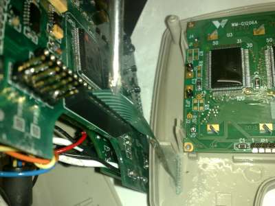

          a bit off topic as a question?have you ever had issues with the slot in battery pack,into the armrest housing?random switch off an on,with a loose battery pack?
          I dont know if this is typical for these units? I have an ML Explorer an it does this?
          Rov
            on my machine NO. not happened to me as of yet but i have heard of it happening to few peoples machine. if it keeps happening after cleaning the battery terminals its a fault on the power button panel if i remeber rightly? and thats a job for minelab. if you look at the gif & pic below you can see why. one peace panel.
              Yes your right about the front panel on the Explorer.I dived into the case 3xpcb here,and the front panel ribbon cable dislodges from the connector,seemed to be my issue.not seated fully in,an only making intermitant contact ,time to time.All ok Now.all panel buttons functional! Great!
