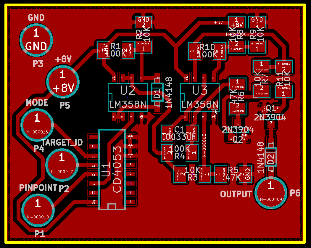

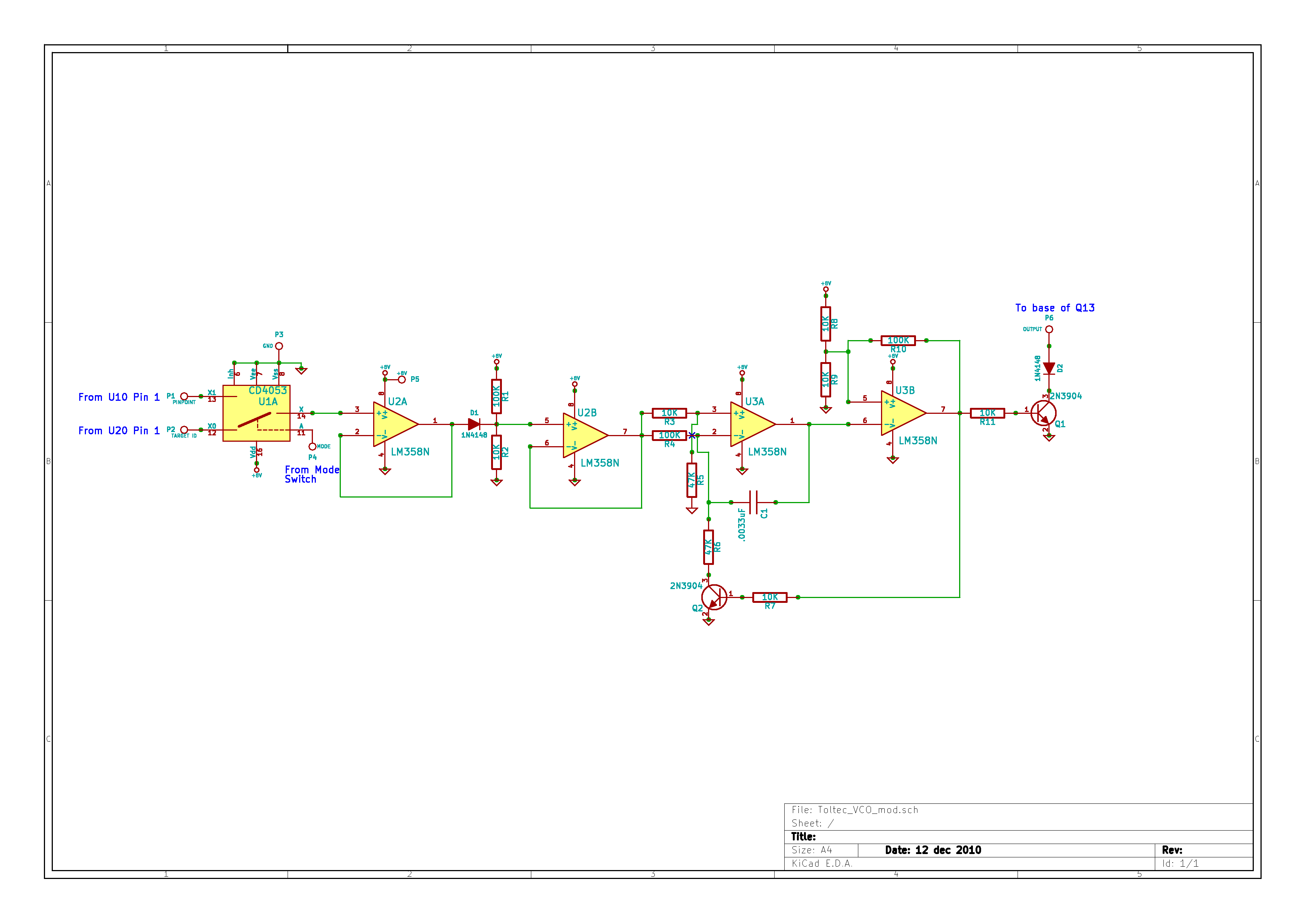

    This is part of a project I'm working on that's based on the Toltec 100. This will add tone ID in discrimination mode and VCO pinpointing in all metal mode. I have it built on a breadboard and have it hooked up to my Toltec 100 and so far it seems to work fine. I have built a PCB layout(SMD) and have all the parts I need except for the CD4053 which I ordered the wrong case style. Never tried working with SMD so this will be a learning experience.

    Hello, Merc. Unless you have a halo-lamp or binocular microscope, you should stay with 1206 or larger size R-C components as much as possible. It looks like that's what you're doing so you should be OK.
    Even still, you'll need a head-magnifier at a minimum before you should tackle SMD. It's good to not have a bunch of holes to drill, but SMD can be a headache without proper tools. (Ask me how I know.)
    The Toltek looks like a daunting project, especially considering that the RC4200 multiplier chip is extremely rare nowadays. Did you find an inexpensive source for RC4200 or do you have a work-around up your sleeve?
    Also, I'm curious about your VCO input range. Won't that be a bi-polar signal coming out of the analog switch; so why wouldn't you use a bi-polar power supply?
    Good work on your PCB.
    I tried KiCad many years ago but could not even get a toe-hold to get started. I was stymied, so I'm stuck using a "free" version of Eagle.
      I am planning to stick to 1206 size SMD as much as I can. I have a magnified light to use and my closeup vision is still OK. I got three RC4200AM SMD off ebay for about 4 bucks each. I just bought a Toltec II an noticed it also uses an SMD RC4200AM which makes me think tht Toltec II is not too far off from a Toltec 100.
      I have used Kicad for a while now. I just couldn't figure it out for a while and then I found a simple tutorial online and that was the breakthrough I needed. I use it under Linux and Windows. My main PC for PCB work is a Linux box with dual 20inch monitors. In Kicad, I can have the schematic open in the left window, the PCB layout in the right window. When I click on a component in either window, the other program centers the screen and crosshair on that same component.

        The VCO input will always be positive I believe. I am basically using the meter signal and the meter does not go negative. The circuit has a minimum frequency set by a divider network. I had to do this because the osciillator would not run with 0V input voltage. I also wanted to limit how low the VCO would run. I need to measure the frequencies but just going by sound it works great as is. I get a nice high tone on quarters, a much lower tone on nickels and foil is below it enough that it's easy to tell the difference.

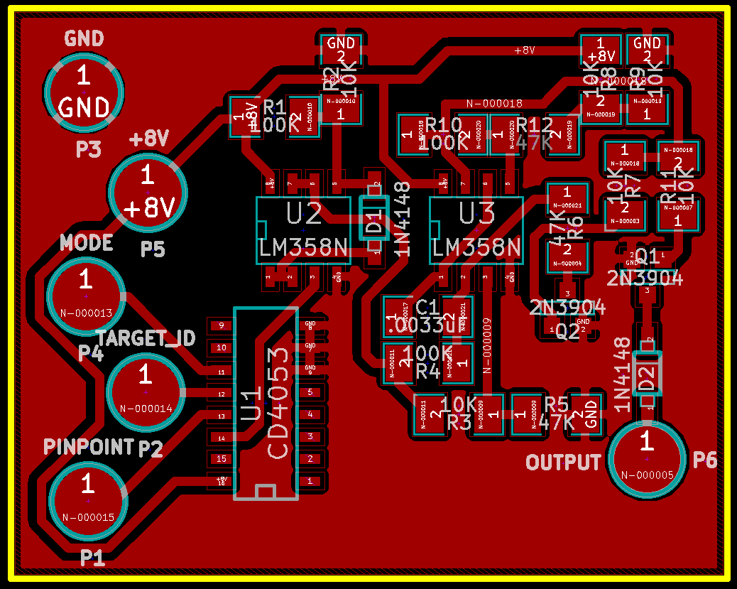

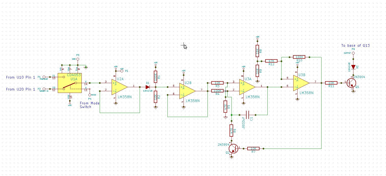

            I just found a mistake in the schematic. I didn't notice it until I built the board today and installed it. It did not work right and I finally found that I had left a resistor out. I have added R12 on this schematic. I have the mod installed and hope to try it tomorrow.

              I'm attaching a corrected layout with the added resistor.
