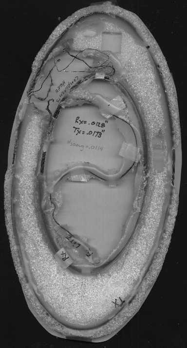

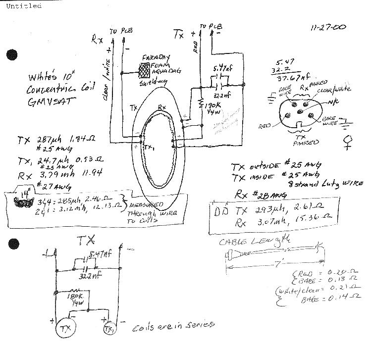

        The photo I tried entering a few months back I couldn't send it, but it worked this time. This is the insides of the standard concentric 10" Gold Masters series coil. The components are out of the coil. This should be actual size. The Rx and Tx guaged are located inside the coils. The small square on the top part of the coil is where rubber is connected to electrically connected the agua dag top and bottom of the coil covers. That is connected to the circuit ground. I will try to post the schematic on this forum. Rick S
          Re: Goldmaster Mods??
          I notice that not all of the drawing make it, so here is another try. Rick S
