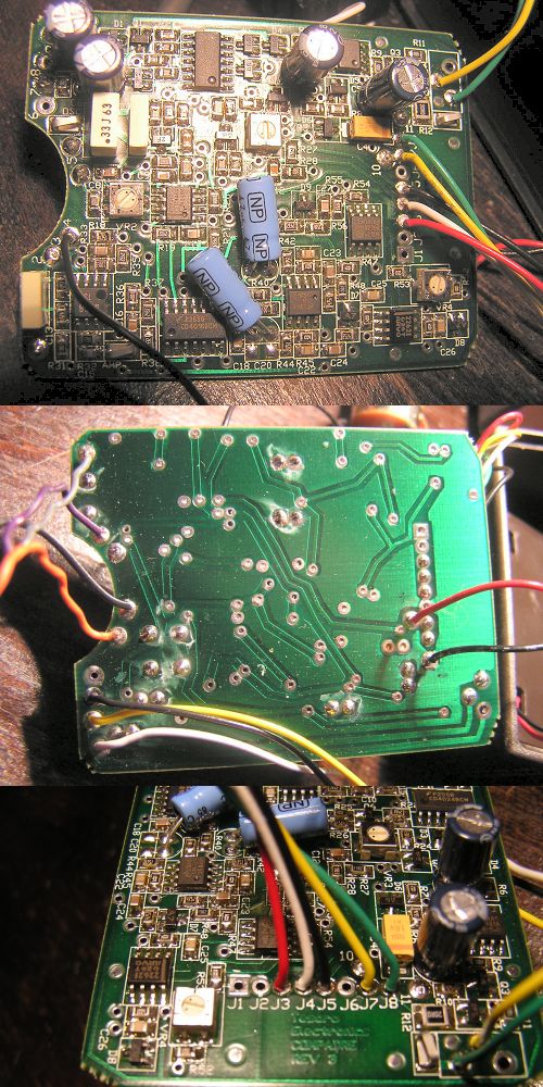

There can be added panel mounted sensitivity knob very easily, because there are free solder pads intended for the potentiometer. Just remove VR4 trimmer and connect potentiometer with one resistor.
Add the slim-line coil connector also and I believe after that your Compadre is upgraded to Laser Scout or Cutlass MicroMax.
