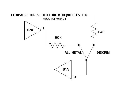

Try a switch that disconnects R40 to U1A pin 3 and connects a 200k resistor from U2A pin 1 to U1A pin 3. This may give you the threshold tone for ground balancing.
Pepso, Compadre Threshold tone...
