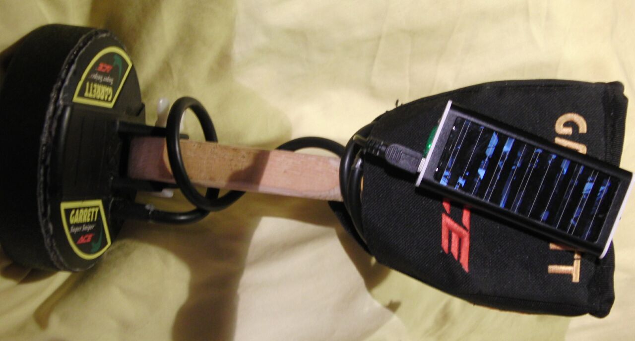

    If you work with a very powerful MD with large coil like Jeohunter you need a very good pinpointer, too. Because sometimes you'll find two or more objects in one place that give just a merged single signal or the object is buried deep and has a special position/shape so it is off center, and not in the middle of the large coil. For shure without a good pinpointer you'll blame your detector for "wrong signals", but that's not correct.

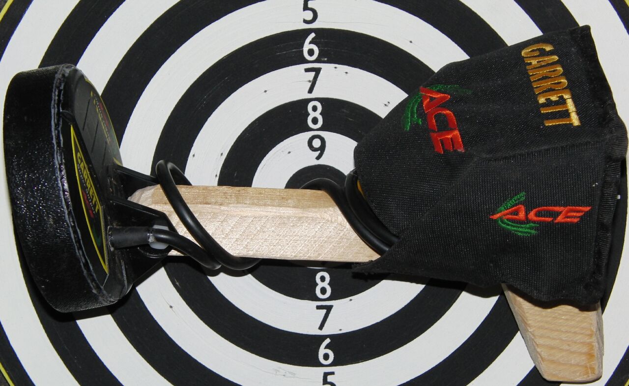

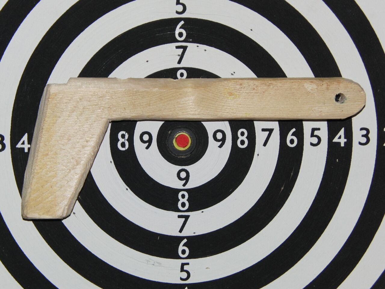

    How the mod works:
    All you need is a small wooden board, lenght around 20-25cm (a bit shorter than 1 ft) and 2-3cm (1'') thick. And it's very practical if you have the little sniper coil. Fine if you have an additional plastic screw and a driller because the board needs 2 vertical holes for the plastic housing and one for the coil.
    For using solar power get one or two of those cell-phone loaders with integrated accu and USB-etc. connetors. Those provide around 4.5v DC which is enough for the ACE250. Mine has a femal USB mini jack and the male USB mini-cable was soldered directly onto the mainboards battery connectors. The solarcell-accu also is rechargeble over 220v adapter and if fully loaded the ACE250 works over 10h with it (mine has 1350mA).

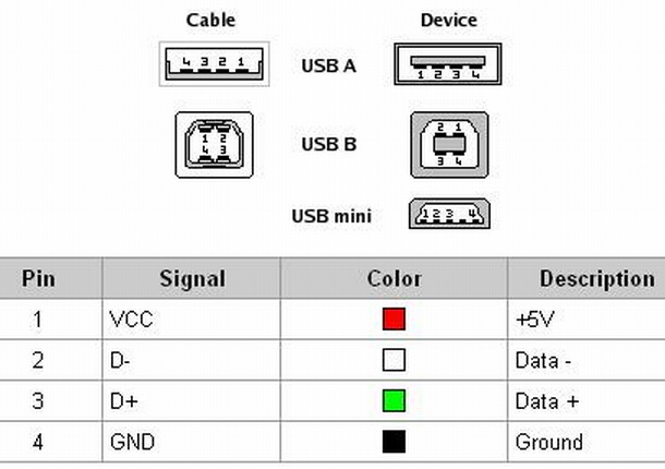

      hi wallker
      there is no schematic - it's a simple "battery-cable"-connection.
      if you have solar-cell-accu-pack with USB, connect cable (USB Mini)
      you have cutted before to ca. 15cm and test polarity - most of the
      time you should get +5v @ red cable and ground @ black cable.
      Solder the end of those cables to the correct battery connectors
      or directy to the Ace250 PCB battery contacts. Good luck.
