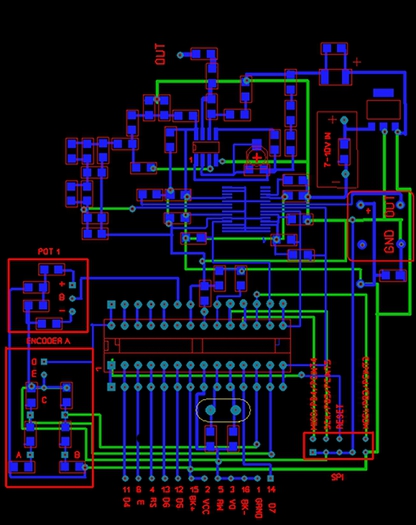

I thought I would share this with you. This mod should also work on the SD2000s.
I got tired experimenting with analog caps and therefore created my own digital frequency switch.
This mod is not very difficult. It simply consists of an LCD, potentiometer, rotary encoder and the awesome Atmega328P Atmel uC.
Once constructed, you should be able to traverse a predetermined frequency range from 1,000,000hz to 1,875,000hz (default is 1,200,000hz or stock).
My main priority with version 1 was proof of concept, which is now very stable!
Simply select your speed by using the potentiometer and increment/retard the frequency by turning the rotary encoder.
The frequency will step from the current frequency to your selected frequency. In other words, instead of jumping from 1,200,000 to 1,201,000hz directly, it will do so in increments of (.01x (1,201,000-1,200,000)). It accomplishes this very quickly in 100 steps. Doing so will disrupt the threshold far less than performing a frequency jump. However, this option is configurable. You can simply add a switch to pin 4, PORTC of the 328P uC to select frequency jumps. In the future, I may include this switch in the schematic to select Auto Ground balancing (Frequency "Step", "Jump", "Auto GB").
In future releases I will also optimize for battery usage, which shouldn't be that bad.
*Use the encoder to traverse the frequency range.
*The button on the encoder is to save the frequency to the uC's eeprom. Once you have found a frequency that works, simply save it. Next time you boot your detector, it will load that frequency.
*The Pot is to select the speed . Nine speed options are available, in increments of 1hz, 1,000hz ... .01xtop_frequency.

Save as xxx-V1.hex and flash to your micro.
