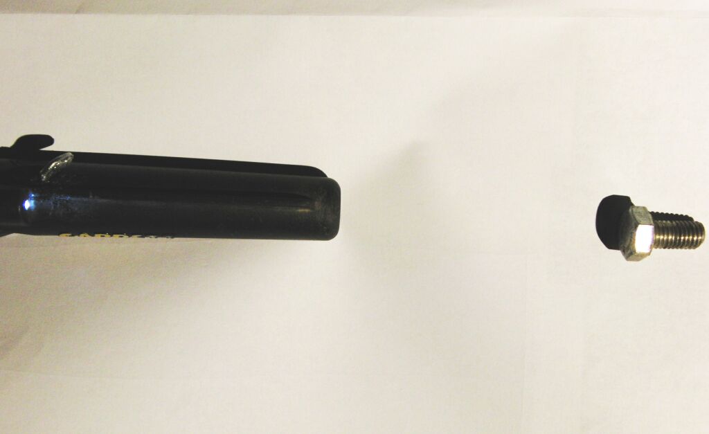

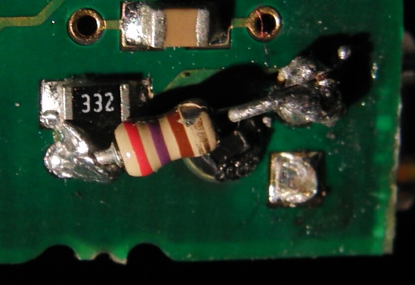

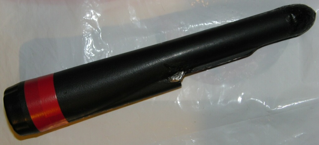

Depending on the objects size this little switch makes the pointer 2-3 times more sensitive!
fridge: 25cm -> 50cm
little screw: 1cm -> 3cm
Usage:
1. Move switch to counter position of the pointers tip.
2. Press pinpointers ON button.
3. Move switch until the pointer almost starts beeping / vibrating.
4. If there's some electronical-drifting readjust after some time.

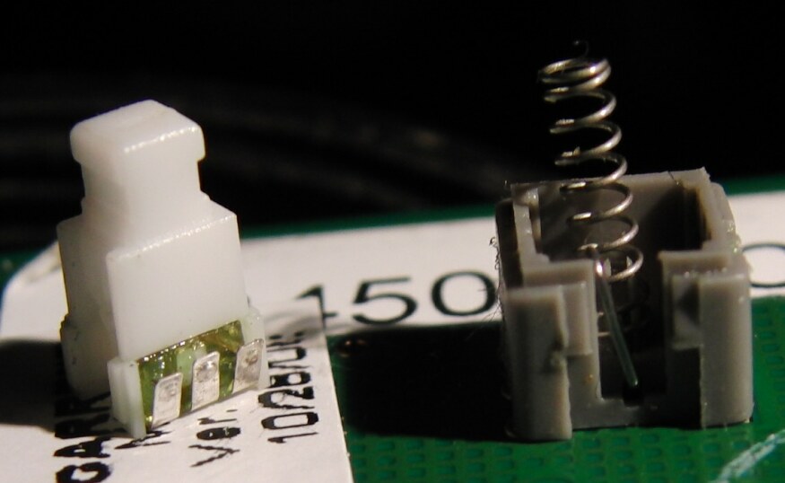

The switch is a little selfbuilt variation of those who are used to keep old windows
closed but even a small nail or little bend screw would work as long as it fits tight.
