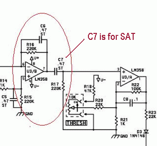

    Has anybody added SAT to their whites Surf PI ?
    I have seen some rough drawings of the mod
    but does anybody have a good drawing of the sat mod please
    as I would like to learn how it works
    And where did this drawing with its hand-drawn changes originate anyway?
    I've seen it reproduced again and again but am curious of the origin.
    Barry
      I thought Sat. on your Whites applied to a VLF detector,and not as per a PI detector that requires multiple channel for ground balance and retune functionality?
      Maybe Ive missed something?Fill me in please?
        Today Nelson asked how to remove SAT from White's Surf PI . Here is the circuit diagram and my answer.
