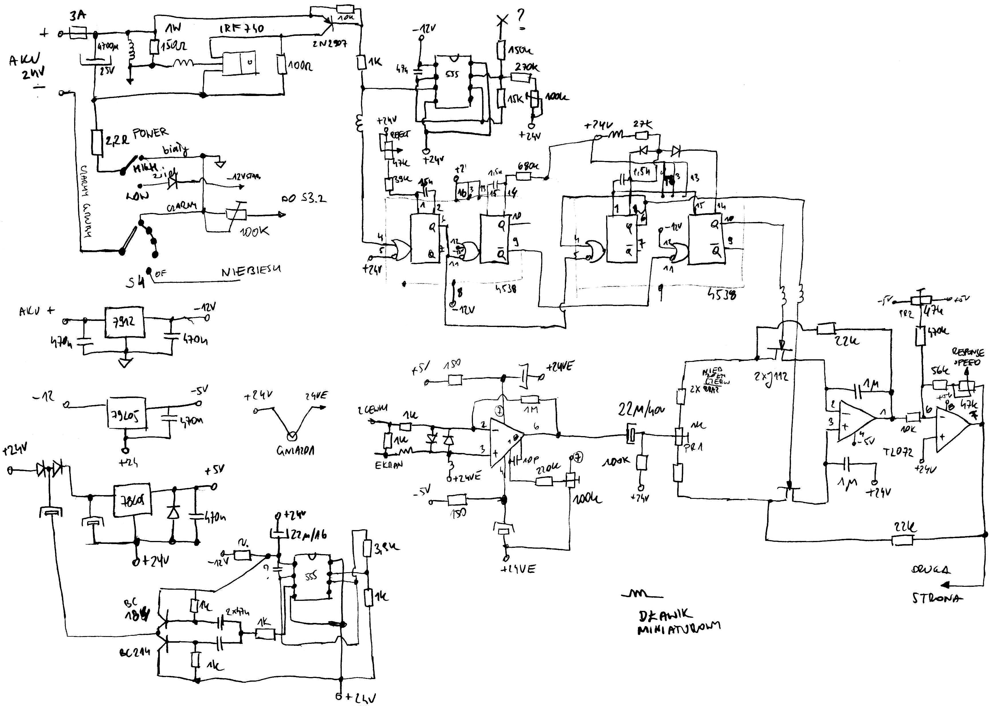

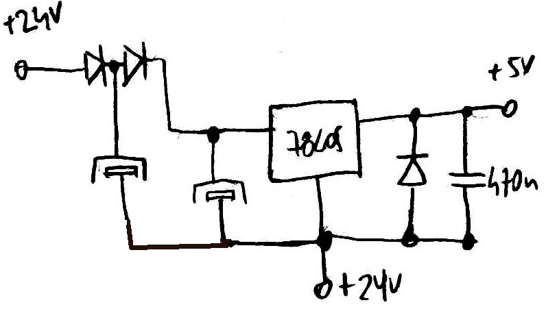

Superscan uses 24V batteries.

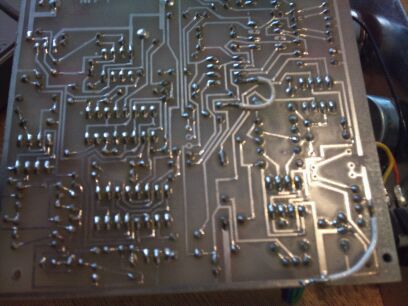

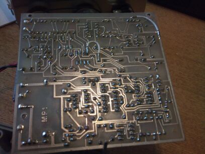

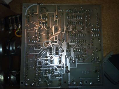

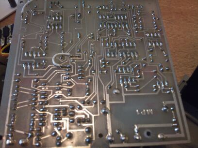

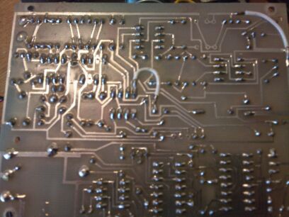

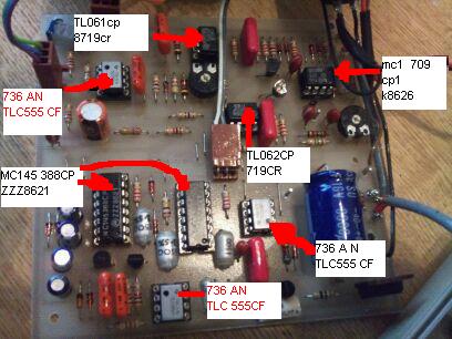

I agree it is not Minipulse, but his ICs' list are too identical that I have did see at the photos. beside the stabs and power supply is not 24V.
it was only some help to give a vector... I have not the schematic of Minipulse... but I hope to get all schematics of Eric Foster with Gods help as well
