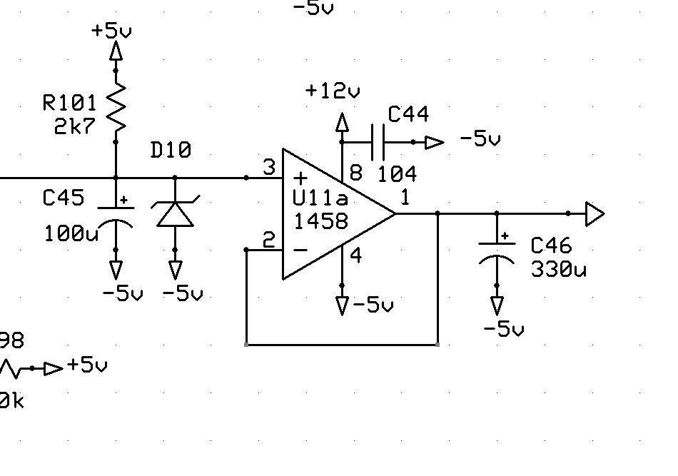

          schematic golden mask 2
          AL 9pd the stabilizator is

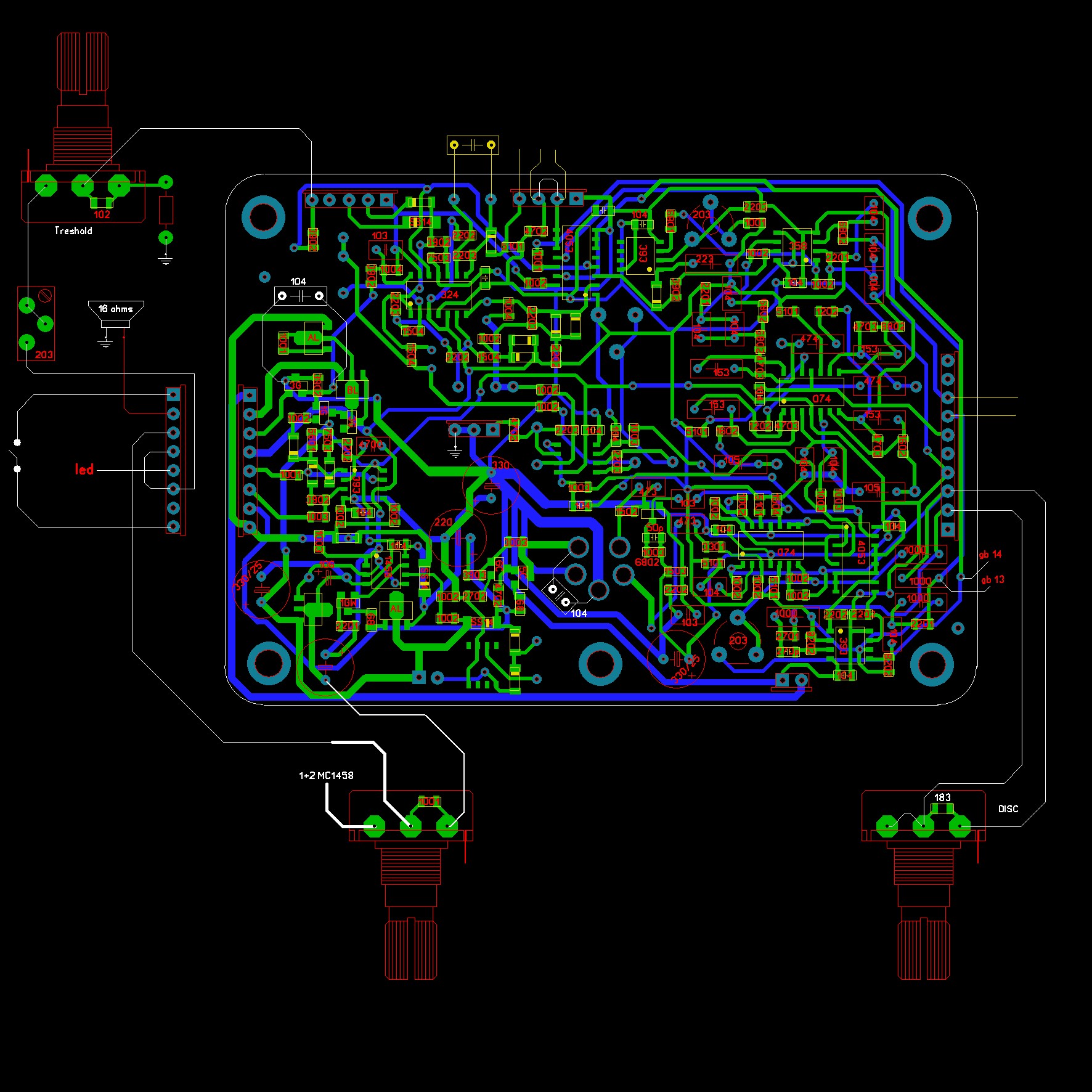

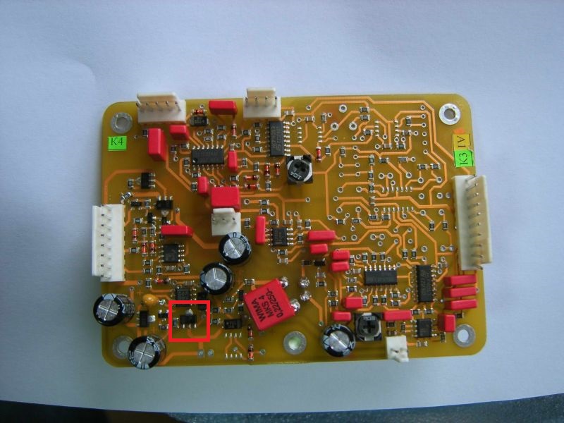

            Oros,
            Do more pictures and more detailed images - top and bottom!
            Please!
                Brilliant work (as always), ivconic.
                  Ivconic,
                  What does it mean "1+2 MC1458"?
                    Originally posted by Toros View Post
                    Ivconic,
                    Wire to 1. and 2. pin on MC1458, virtual ground actually.
                      I do not understand! If you touch this leg of the potentiometer to 1 and 2 pin of the MC1458, it would mean that shorting inverting input with the output of op amp. Why?
                        It's a virtual ground.

                          What role performs this potentiometer?
                            Thank you!
                            Volume.
                            You'll better take "Magnum on steroids" schematic and analyze it yourself, it is everything there.
                            "Magnum on steroids" covers all the "Golden Mask" models until basic model 5 and beyond.
                              I resolved detector repaired
