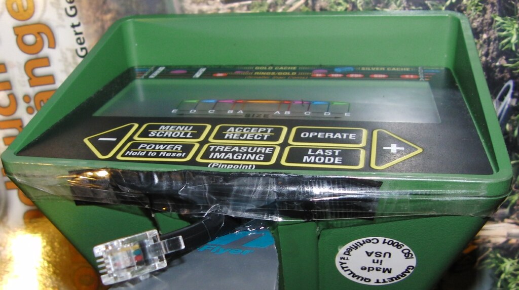

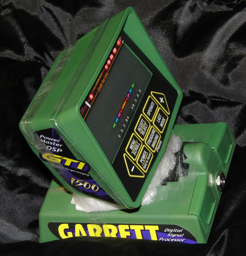

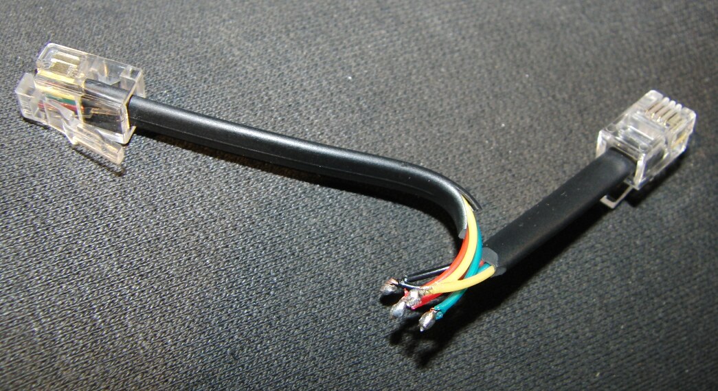

    There is 4 wire US-phone-modem cable that connects the unit with battery-case including speaker. I can give you more details if you want.

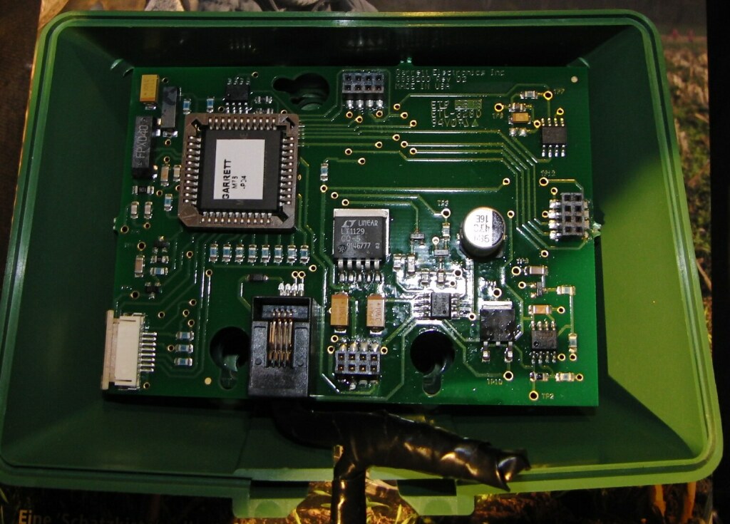

        First dismount the detection unit from the holder.
        There are some screws below the holding-rubber but
        you also have to open the detection unit carefully.
        The display-circuit-board is attached by some jumpers with the boards below where the cable conector is soldered.
        There is also the flatribbon cable for the LCD connected.
        Believe me, it is much better if battery and display unit are close together. You can try with battery at belt, but in this case you need to get out the long modem cable from the holder and you will have 2 instead just 1 cable around your body.
        The coil cable must be at least 1m more long. You can use even some stable coax cables for this, no problem.
