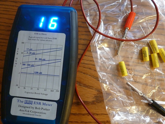

Name:	ESR Meter 004.jpg
                            Blue ESR Meter testing 400V .1µF cap
                            If you want to check the caps in circuit, as long as they're not parallel, most ESR meters will work just fine. I have the Blue ESR meter but there are several on the market that will do the same thing. You have to know what ESR a cap of the same specification will have when brand new. In the picture I'm testing a cap that I'm going to put into an vacuum tube tester and an old Heathkit integrated tube amplifier from 1959, I bought a half dozen of them because it's a common high voltage cap that goes into a lot of things.
                            When caps age and dry out their ESR drifts way up in value like an old resistor, plus when the caps age they get leaky or can't hold anything at all.
                            Note: the ESR meter has red and black leads but it doesn't matter. It uses a few millivolts of AC power and doesn't have a polarity, you can use whichever lead you want on either side of the cap.
