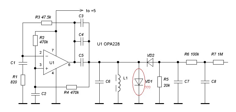

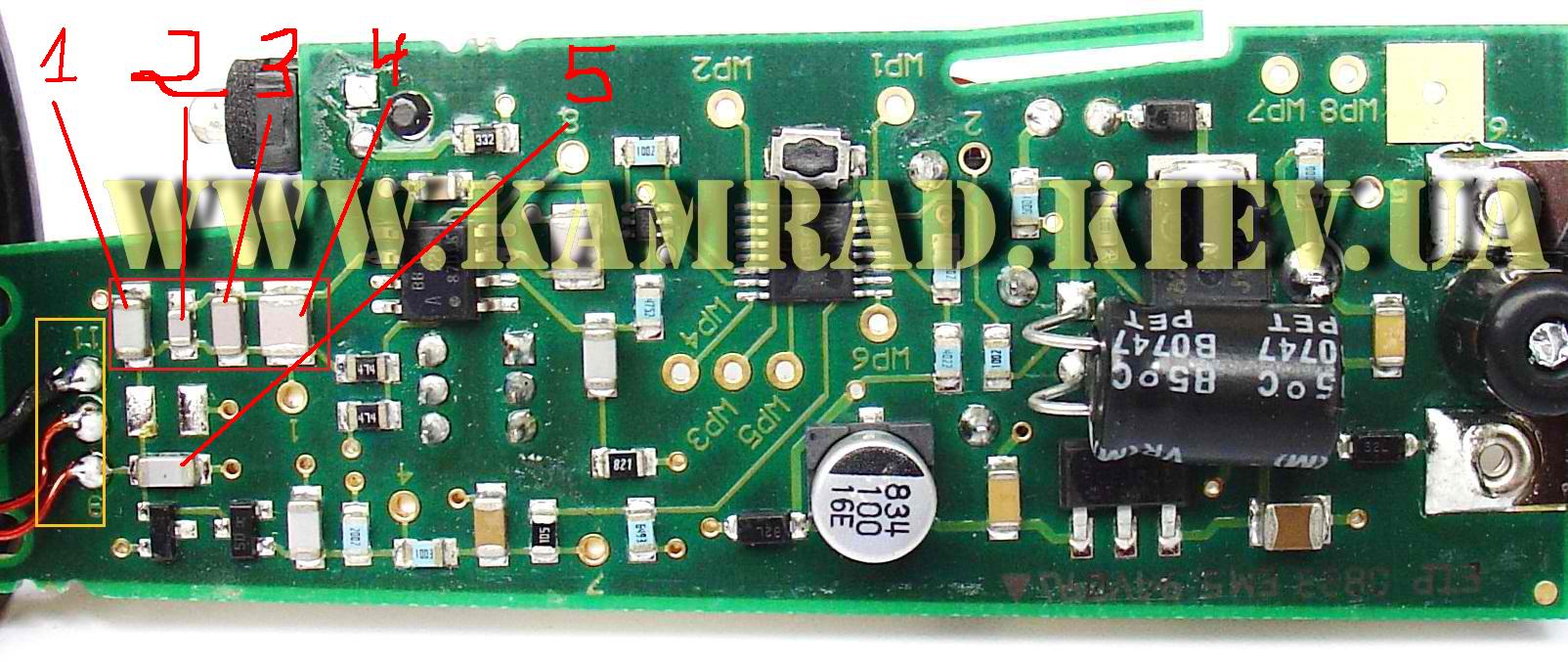

        Bringing this subject back. I am wanting to turn this into a hand held pin pointer, similar too others like the garret pin pointer.Has anyone done this before?
          dfxmadness, if you will find garrett pro-p in non-working cond at sales knock my door I will begin new project and you will get the copy.
ID:	335649Click image for larger version
