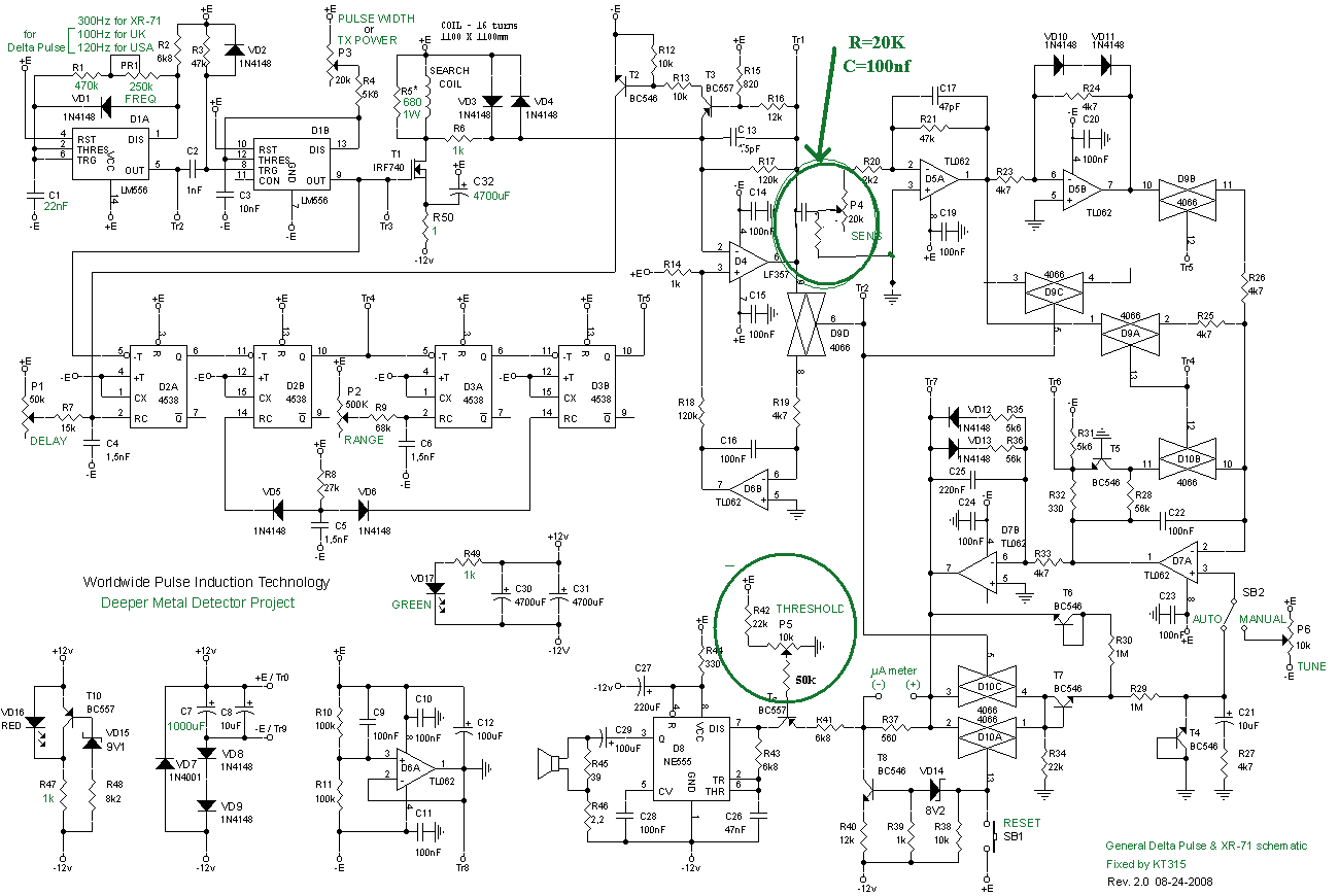

reduce electrical noise in delta pulse
  • reduce electrical noise in delta pulse
    insert an RC network after LF357 reduce the electrical noise from environment
    also the gain work better
    try playing with c and R value
    because this is low pass filter
    and work in some delta pulse frequency
      electrical noise
      hi ossamaussama delta pluse is pulse induction very low 350 hz frequency detector so no need to noise filter. if you have more modified to do iron reject mod in this device.
