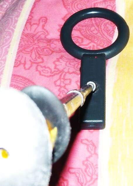

    This is my newest invention - the producers should extend
    their Security-MDs as default with such a very useful hole.
    Upper side the diamter is around 1cm and down ca. 7mm.
    You can use a simple ski-stick or a tripod telescopic-bar or so.
    There exist much more lightweight solutions than ski-sticks.
    This mod is simple:

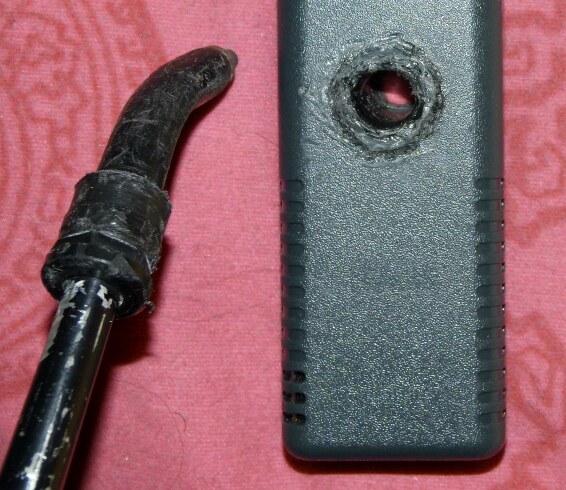

    Find a useable stick with bendable and slightly conical tip
    so it will tight fit into the MDs hole you have to create.

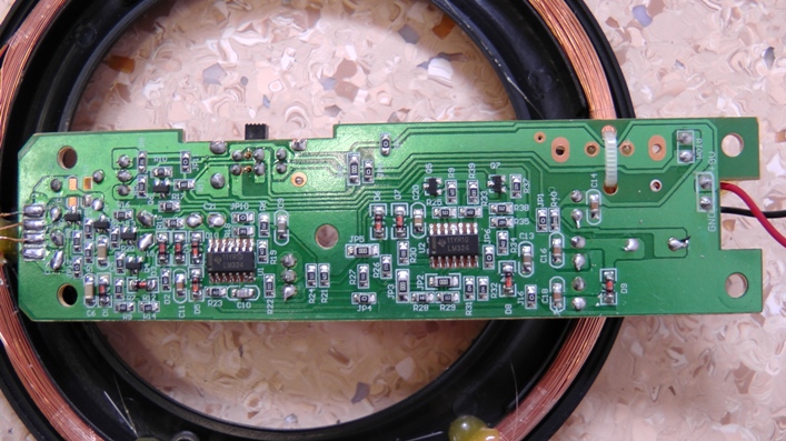

    Open the MD and look for a place where you can melt 2 holes
    with the soldering-iron without damaging cables or the pcb.
    Search for a short conical tube made out of gum or rubber or
    soft-plastic or create something like this from all kind of stuff.
    My tube was made from a rubber kind object of the ski-stick
    and connected by soldering and mixing both plastics at the
    upper side of the detector. The bottom end of the tube was
    left unfixed for further possibilities to open the detector.
    This is the absolute lightweight solution and for taking a
    MD even to otherwise not possible sites or locations!
    And the cost of around 15-50 bucks is riskless if you
    have to however leave behind your equipment.
    Those handheld-MDs have different detection-depths
    but most of them are good enough for ground search.
    Of course there is no disc or ground balance but the
    size and weight is unbeatable, you can make your
    kids happy with such a cool treasure-hunting-toy
    and for some occasions such a MD is: "priceless".

    By the way, how it works? It has two windings - TX and RX but both have the same size.
    Does some one know the theory of it?
      Thx for your interest.
      Probably there are different types of used ciruits.
      The one I have is "signal while moving near metal" only
      and I guess it has a very simple integrated circuit solution
      where the IC compares emfield energy/loss of the both coils.
      It needs just a few milliwatt of the 9V for the field-strenght
      over the 12.5cm / 5'' coil and has no DD configuration -
      otherwise the sensitivity could be alot improved.

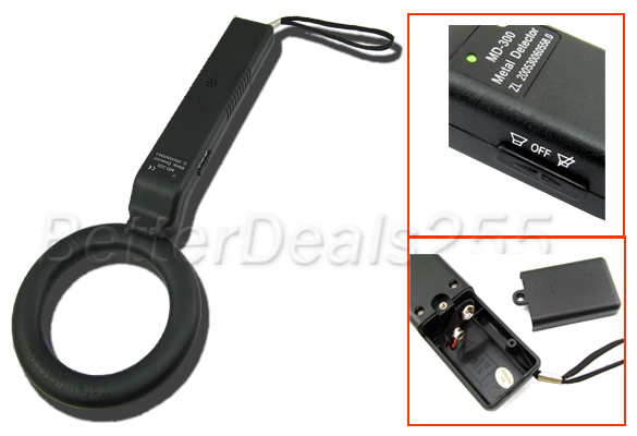

        MD-300
        Hi, this is what You get for $17.00 with free delivery from HongKong on Ebay
        It can detect fridge from more then 50 cm if sensetiviti pot retuned.
