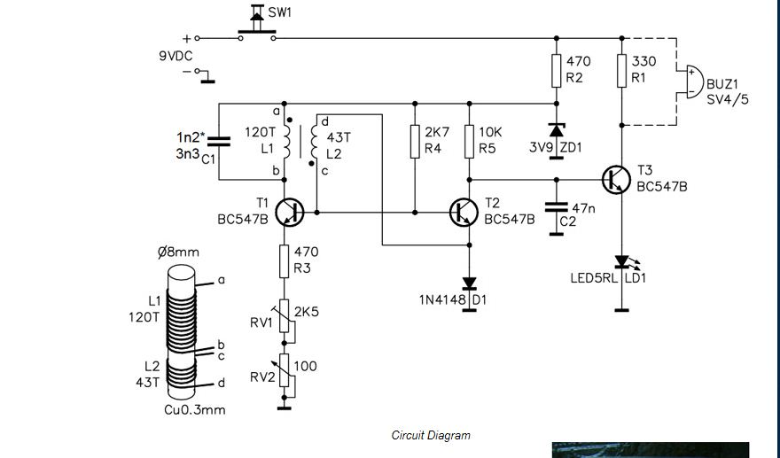

    would this make a good home made hand held pinpoint prob project?

    Here is one about like it but less parts count.

      I built that years ago, poor detection range for coin sized objects, average 1cm
      I have tried several pinpointer designs as it is something I would like to have as a project
      I have some boards for this project on order, it seems to be promising
      http://www.youtube.com/watch?v=imhGp...ature=youtu.be
      Full details from here http://www.md4u.ru/forum/viewtopic.php?f=19&t=6001
      On the positive side it is tiny, runs on 2 x AA and will fit nicely in a tube type probe housing, seems to have decent range, not effected by temperature drift
      On the down side for some, this will be Surface Mount, so get your glasses out

          Boards are very small so about £2 GBP
          I will do kits as well, when I'm happy with it
