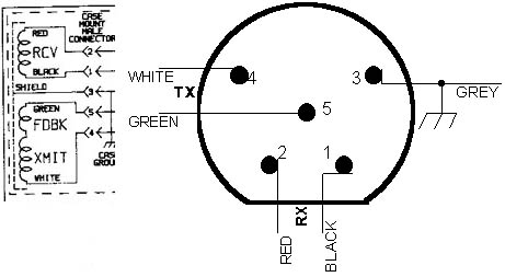

    Where can I find the plug that goes from the coil to the box?
    I have a Coinmaster Classic 1 (8 inch coil) and would like to mod the coil Wire so that I can switch it from that detector to my XLT E-Series.
    White's uses SWITCHCRAFT SL405FX Slim Line Connector, female, 5 contact, pin arrangement D on cable side.
    earlier this type was SL405F... why now FX I am not in course what it means.

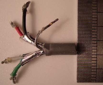

      Thank You. I just remember I have a non working DX-1 Probe. Would that still work? Are the wires the same color and would the go in the same locations?
        dfxmadness,
        please write more about what is 'DX-1 Probe'. I do not aware these things from your part of the universe which in our part is only black-box. some photos of the probe on cabel/connector side will be greatly appreciated. then I will say due what I see.

            Added new photos of the loop plug that goes into the classic motherboard.
              seems we say on another languages.
              I have asked about THE probe but I do not see the probe at photos I see some cabel (of Coinmaster Classic 1 (8 inch coil)???) and connectors. the cabel is not that Whites uses. while a connector to PCB has clear colours of Whites cabel wires.
                Thanks You. it looks like is will not work.
                  i think it will work good. you need only right correspondence of the wires in the connection.

                        so the p/n is sl405fx plug sl185fx connector
