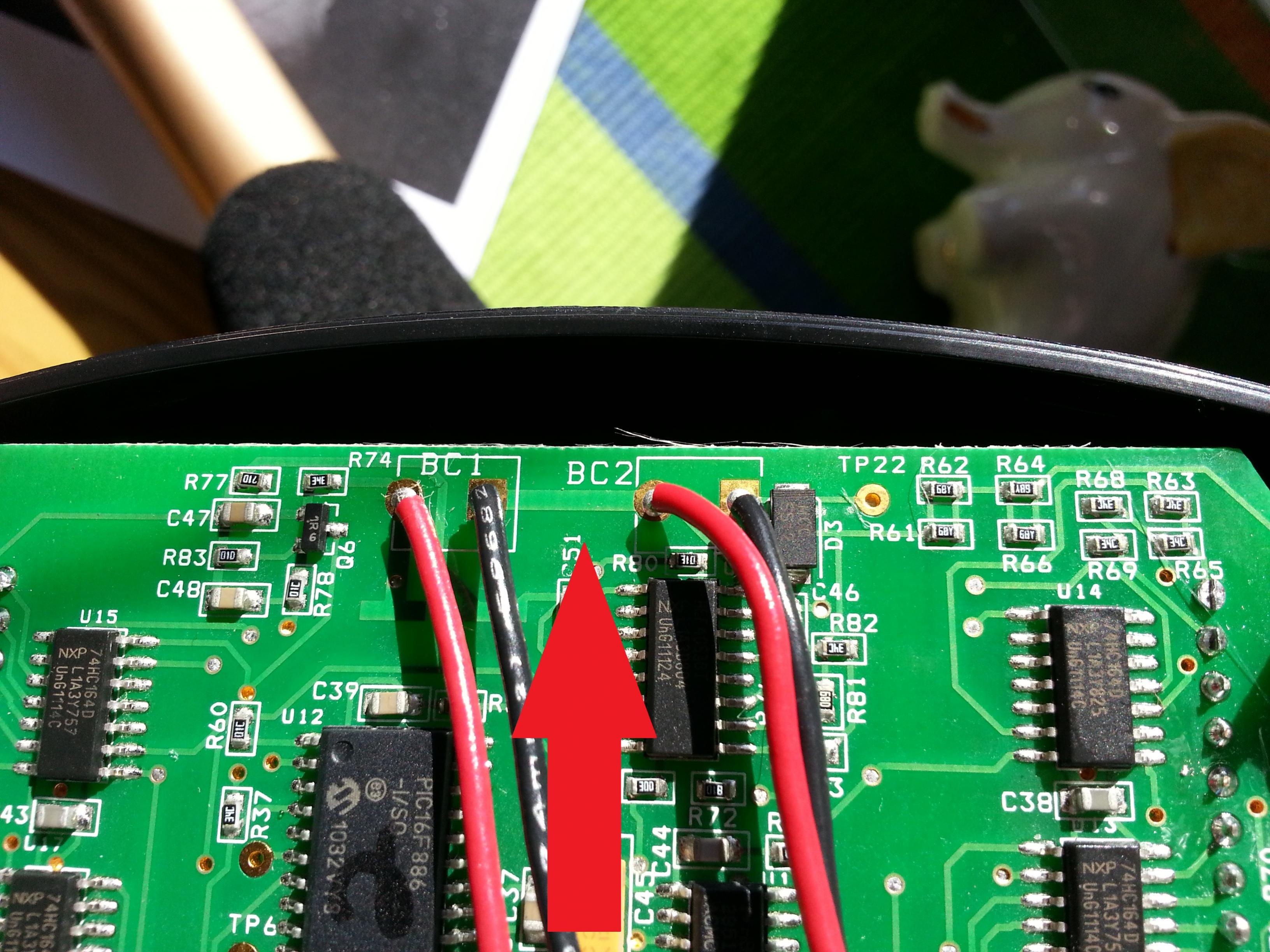

      hehe, yh im trying to figure out if the F2 actually can handle the jump from 9v to 12. but from what i have gathered from yourvibes it should be ok? im waiting on an reply, i have the f2 open and i am currently adding the 10k pot for ground balance.. =) gonna use a 11.1v lipo battery if i have understood yourvibes correctly and he is putting 12v into the MD this should be fine =)
        fisher F2 input voltage
        I think i have figured out this F2, it seems that it runs on 18v, that the two 9v batteries are in series. there is probably a voltage regulator that is regulating it down to 12 or so volts internally, and that is why it can run on the 12v battery in yourvibes case. im not 100% sure about this. but that is what i have found out after an hour or two of measuring and studying the pcb.
        if you check on the picture you see the two sets of wires coming from the batteries, and you can clearly see that the positive from BC2 is connected with the negative lead from BC1, in other words in series..and i measured 18v..so i think ill just stick with the standard batteries for now. if anyone have some more input ill be happy to hear it, and thanks to everyone who contributed to this thread so far

          cant really seem to let the volt issue be..after some more thinking and speculation im starting to wonder if it is 18v or if it is using +9v gnd and -9v??? (like amplifiers)
          i hope yourvibes or anyone else can help me out on the subject =)
            Correct, the 9V batteries are in series, so it runs off 18V. From memory, there's a series diode (for reverse battery protection?) then it's linear-regulated to 12V,. So the lowest supply voltage I would run it at is 14V. Might I suggest you do the obvious thing, and run it off two PP3 9V batteries like the manufacturer intended, and if cost is a problem, use rechargeable NiMH type. You can get capacities of 160 - 200mAh easily now, they last a decent number of hours.
                thank you thank you for the reply! =) yh i think i will just stick to the 9v batteries for now then.

                          TO all i would not use more than the 12 v power ( !!! i may have been lucky !!! ) !!! who knows !!!. . . . . . !!. . as can be seen in pic from Brudg. . . . UNDER RIGHT SIDE RED WIRE there is a track comming off the 9v power !!!! (i know its hard but look closely you can see it ) ( you have been warned ). . . i know you can see a track joining batterries together to make 18v but there is a 9v track comming off the single battery aswell . . . so i would not be putting a 14v or 18 v into the power input as this would be doubling up later to 28/36 and would not leave anything for the tolerances +/- so would surely blow something . . . . . . . . ( yeh i remember now thats why i soldered onto battery points inside the battery housing ) and not onto pcb

                                yh, hehe. im sorry i was wrong and you where right on the track running over the hole in the panel :P im gonna order the nel tornado 12x13 next week so that i get it around the time the last snow disappear. and yh ofc im gonna share the results with you =) oh and i think im gonna make a video soon showing ground balancing it too. and yes you may be on to something with the 9v track going of there.
