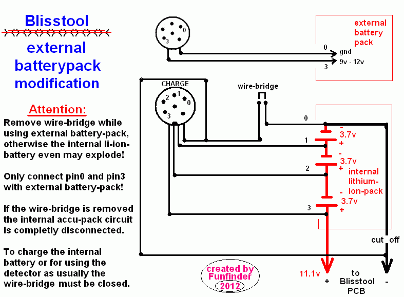

    Today I opened first time this detector and
    created that modification:

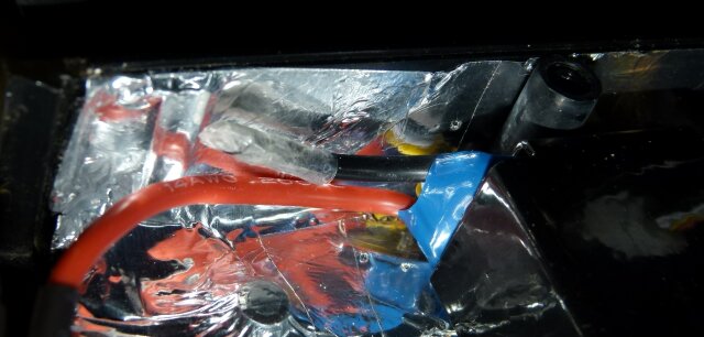

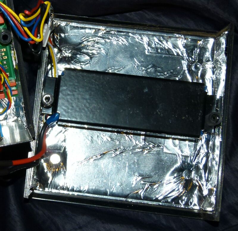

    The Blisstool uses an internal lithium-ion pack
    and if this is empty (after perhaps 45-90 hours)
    you need to charge it again because there is no
    way to use a reserve-pack.

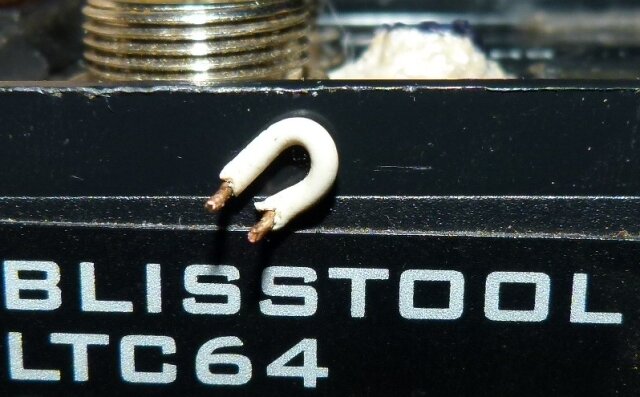

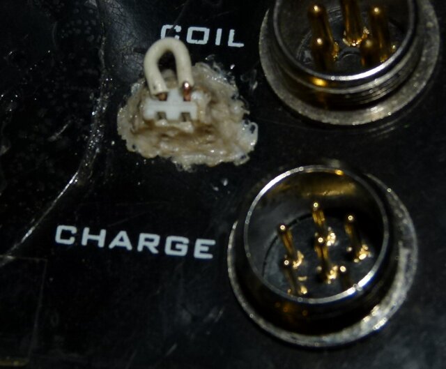

    But it is simple to use the CHARGE connector
    for such second battery or accu-pack.
    Warning: You will lose the warranty if you remove
    the epoxy that covers the both screws on the cover.
    And if you forget to remove the wire-bridge while
    using an external battery the li-ion pack could
    draw too much charging-power within a very
    short time and eventually even may explode.
    So try this mod at home only if you know what
    you are doing and if you have enough electronical
    experience!
    Usually the internal accu-pack lasts long enough so
    it works even after 1-2 weeks incl. 8 hours per day and
    can recharged after this period but for special occasions
    you may want or need the safety of a reserve-pack and
    then this mod is for you!

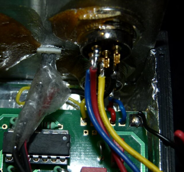

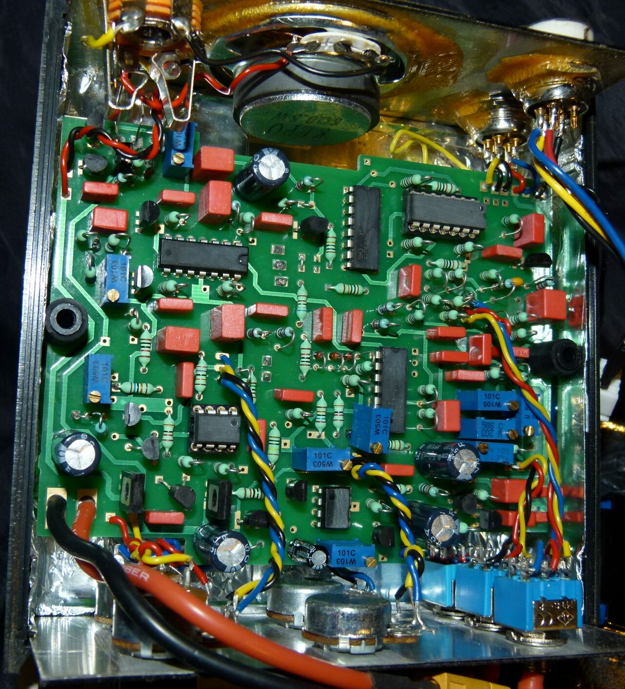

    Can you show some pictures of the circuit board?
    Just curious to see what the inside looks like.
      Are all the ICs in sockets?
        @ mel parker
        You're lucky, made some pix before closing the cover.
        The PCB really is an accurate and straight work.
        @ Qiaozhi
        2 of the ICs are in sockets and the labels are scratched away.
        Though not much difference to the pix we have seen already.
