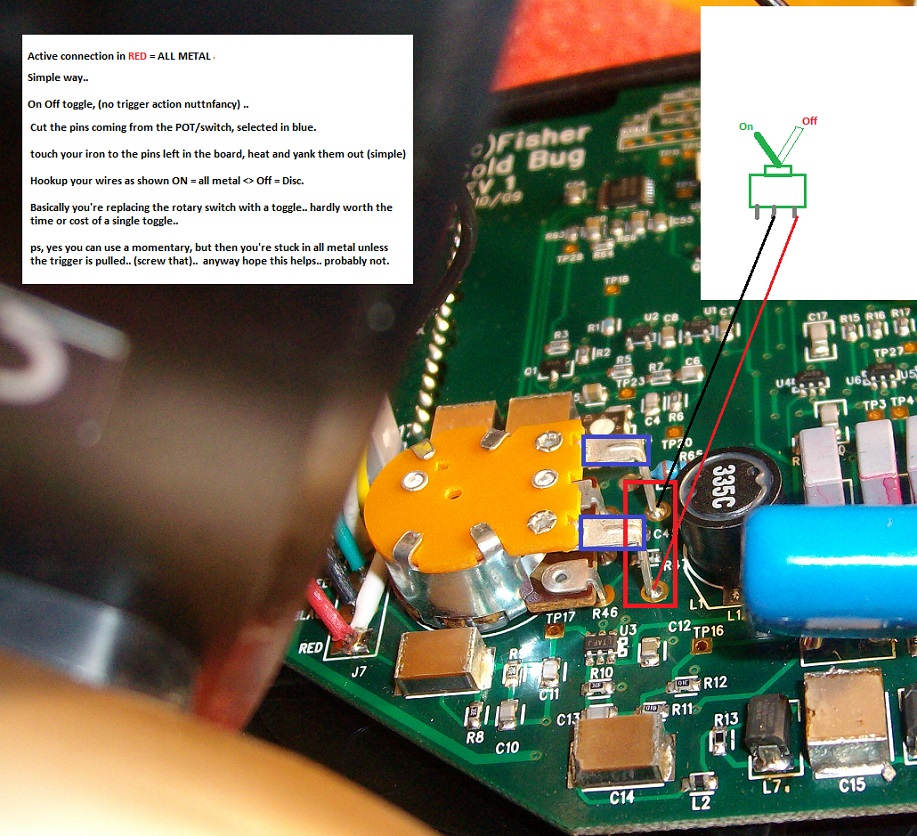

    Hasanyone added a trigger switch on the GB Pro. to switch from all metal to disc????
    I haven't but I like the idea of it!
    At least the GB Pro is easy to get into. The pots aren't PCB mount but are mounted to the PCB via through holes and wired. While at it a trigger for PP/GB would also be very handy.
      Thanx for the reply, it shoulde be easy to do . Will give it a try when I get the time.. DD
        Has anyone done this or any other mods on the gb or g2?
          Very simple mod, 3 pos toggle switch (on off momentary)
          Guess i could mod mine if anyone wants to see how it might be done..
            yes please.
              This is how it COULD be done, I'm not going to bother since I'm fine with my GB the way it is.
