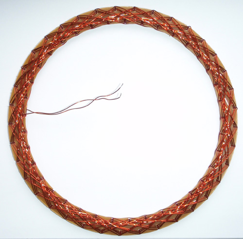

                      I've been away from the forum for a while but have been doing more optimization on my Chance PI. The current coil I am using is 8" dia wound in the previously discussed 'spider' configuration on a .091" thick 1.050" wide polycarbonate form machined with 37 slots .400" deep on the inside and outside rims. The wire I am using is Teflon insulated stranded, silver plated, #26 AWG, .040" O.D. and after extensive testing the optimum inductance for small gold detection with my electronics is 330 to 340uh and about 2.0 ohms resistance. On this coil form this is achieved with 32 turns wound in spider coil fashion.
                      I have also eliminated the coax feed to the coil as it contributes too much capacitance thus slowing the coil down. Instead I use a continuation of the coil wires twisted at a rate of 3 twists per inch. This I will sheath with heat shrink. The low capacitance coil created in this way will run at a Guard Interval setting of 17 on my Chance PI. My previous best was a setting of 19. This 8" configuration will detect a 1cm square of .001" thick aluminum foil at 4" in air. It will also detect a 10.5 grain piece of dental gold at 4" and an 8.4 grain piece at 2". This will also detect my 10K gold ring at 12" in air.
                      I am running this coil without shielding at this point until I can determine if it is truly necessary. In thinking about this specific coil winding configuration I wonder if it somewhat self shields when the outermost winding end is connected to system ground. This is because the successive windings are wound over and around all previous windings. I am also looking at the possible increase in sensitivity if the outermost winding end is connected instead to the high side of the system in/out. In that case graphite shielding in the range of 2000 ohms per inch may be required.
                        One more thing about Guard Interval. I was able to get down to a 16 setting of the Guard Interval by reducing the turns of the aforementioned coil to 28 turns but the sensitivity to small gold suffered. The coil was at an inductance of about 280 uh at that point.
                        Also on my next coil I will try to find some 28 AWG Teflon insulated wire and the smaller wire size should help to further reduce capacitance.
                        In my previous post on Cheap Teflon Wire above, that wire was used to wind a spider coil on the very same form described above. Because the wire was 23AWG and had thinner Teflon insulation thickness, it would not operate below a Guard Interval setting of 19. This was due to greater capacitance from both the thicker wire and the thinner insulation. Still it would be very good wire to use for a coil not intended to search for small gold.

                            Baum7154
                            interesting work you are doing
                            is this the coil you are using ?
