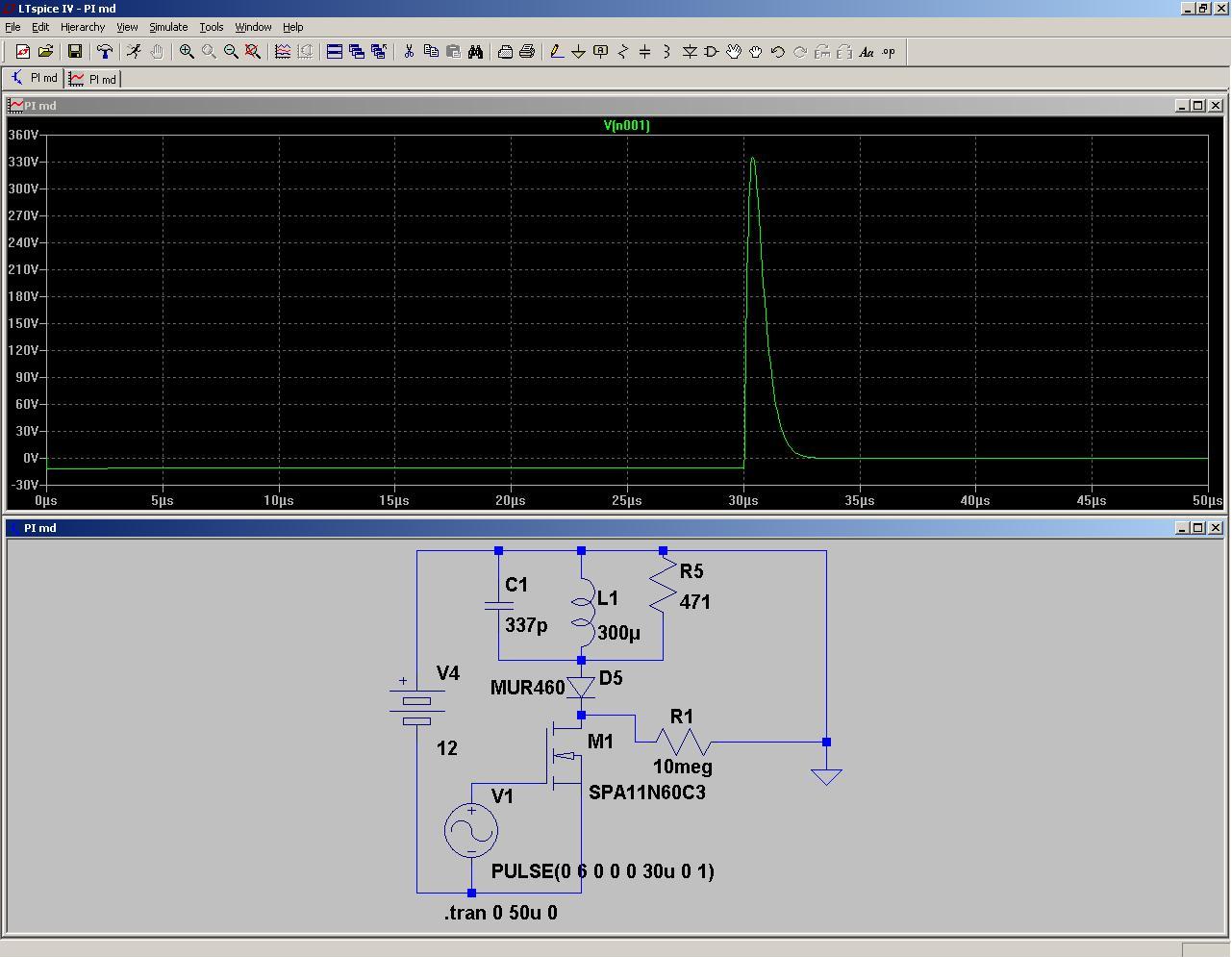

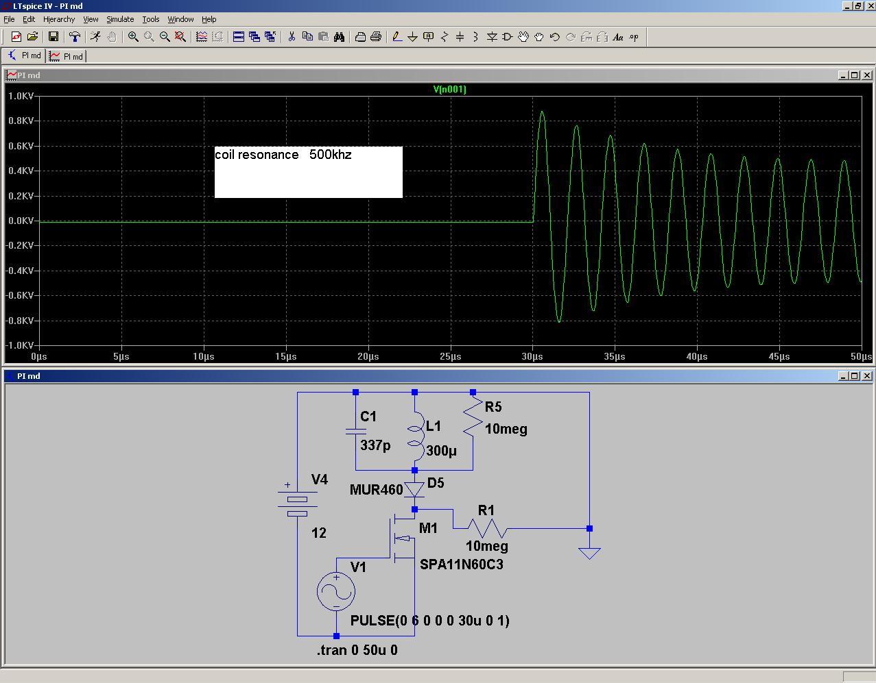

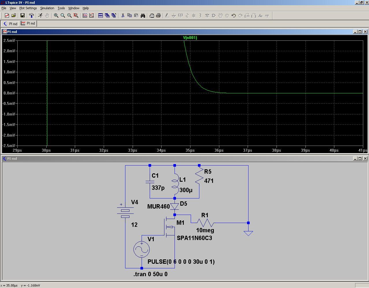

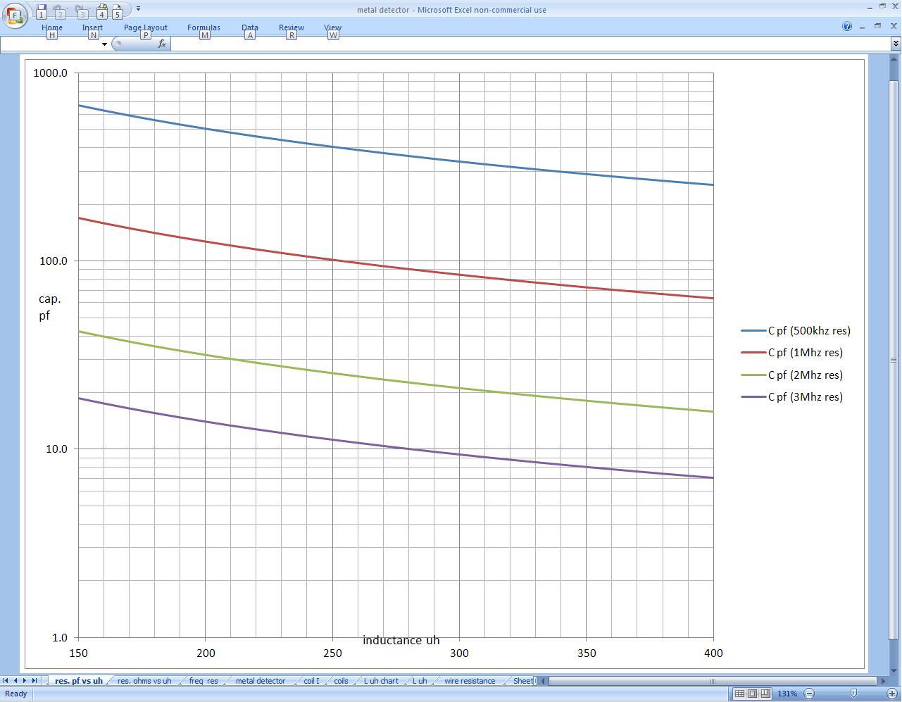

    A method for calculating Rd. Not sure if it works all the time, but it works in LTspice and on the bench every time I've tried it. Rd = 3.14 x inductance in uh x resonance in Mhz. 300uh, 800khz resonance equals 3.14 x 300 x .8 = 754 ohms. To get resonance I disconnect the damping resistor, lay the scope probe near the coil driver, measure the decay frequency or calculate with cycles and period with the scope. The only way I've found to get resonance in circuit is with a MUR460 in series with the fet. I'm using a IRF740 in my circuit. A different fet with LTspice. Including some spice plots. Get the same results on the bench except for the fet clamping at 450 volts. Including a uh vs pf resonance chart for a quick look at maximum capacitance for a given resonance.

        The time to damp near zero volts is about 3/resonance for a normal coil. 3/1Mhz equals 3usec. Any idea why the spiral coil calculates Rd that much different. With the same resonance how long does it take for a spiral coil to decay near zero. Thanks for the reply. I'm just learning and what I'm posting is what I've seen. One way to learn is to say something and hope someone corrects if it's wrong or partly right. It doesn't bother me to be wrong. Being wrong and not knowing isn't good. ITMD and the forum has been a big help.

                I posted the spice model because it's easier to show near zero volts. If I test resonance in circuit or with spice it tests a little lower than coil resonance. Not much, the MUR460 helps. If I use the measured resonance the calculation seems to work, maybe a little overdamped. Spice has been fun to try things but it doesn't show all the problems I have with the wired circuit.
                  (The time to damp near zero volts is about 3/resonance for a normal coil. 3/1Mhz equals 3usec. )
                  Forgot to add time the volts is flat topped. For 450 volts and 300 uh add 1usec for each 1.5 amps until it comes out of clamp.

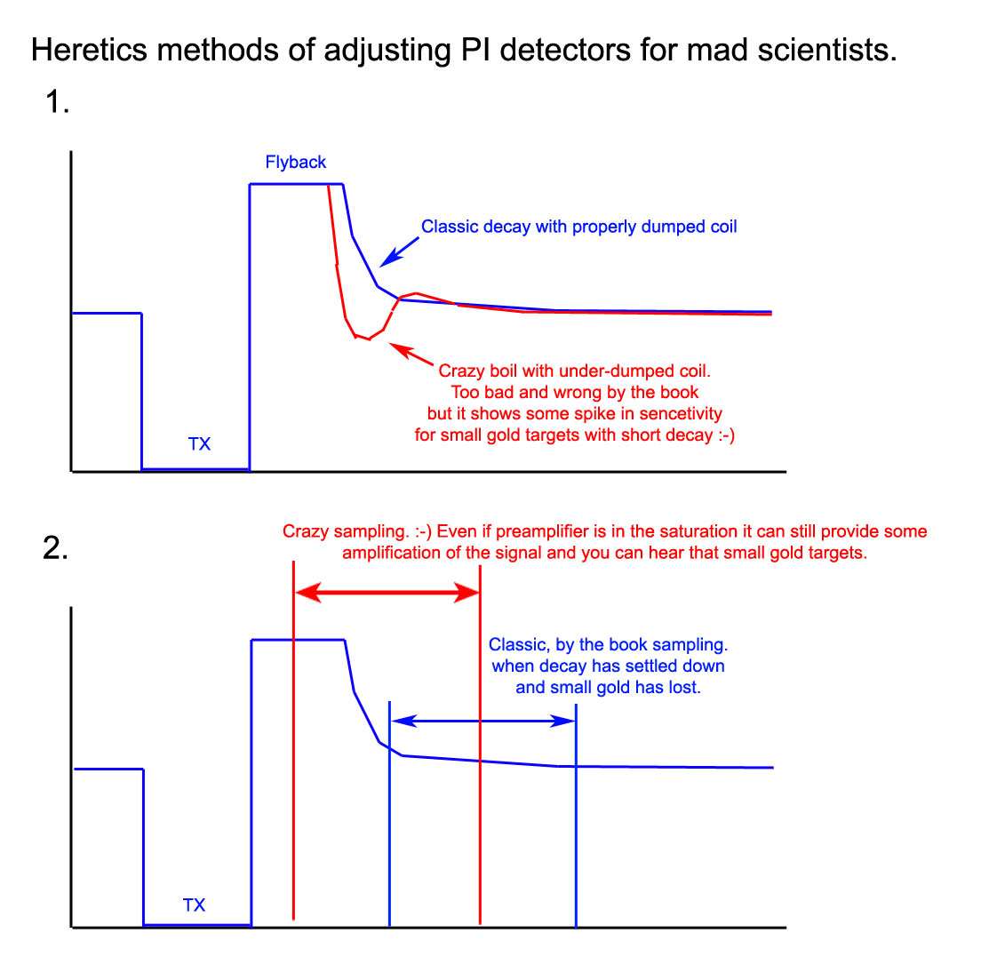

                        I think some day some brave explorer will have that methods of using partially dumped coils developed.
                          You already explored it. Somewhat underdamped coil will work best with almost any classic analog detector. Leaving waveform to bounce in positive direction somewhat, some 20-30% of amplifier output swing (may depend on coil too) will actually prevent early integrator saturation, this positive part will be integrated too, so faster sampling can be used, providing more depth for some objects. With perfect waveform adjusted using scope, integrator will saturate earlier, delay must be increased, you will lose some depth. Cut and try, as usual...

                            Free lunch awaiting!
