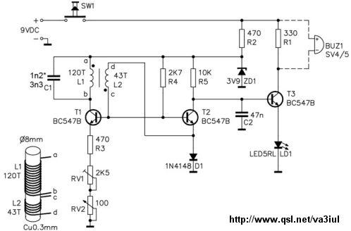

          What design is that? S
            it think its this oneClick image for larger version
            iv'e built it and it has potential(as much as any of these home spun pinpointers), as i said before i'd really like a clicker audio stage for this, if anybody has one.

              On the circuit, I can not say as much because I am considering
              to make a DIY kit, so that with little effort, most people can build a Proper
              pinpointer.

                  because I am considering to make a DIY kit
                  Please do, what is the circuit based on ?
