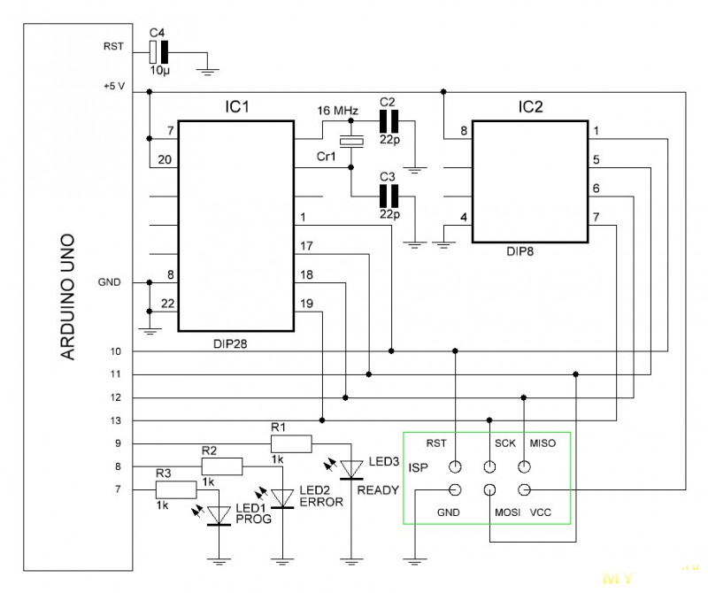

    • Originally posted by CDI View Post
      Can somebody confirm that Arduino Uno can be used as programmer for 3.35 version?

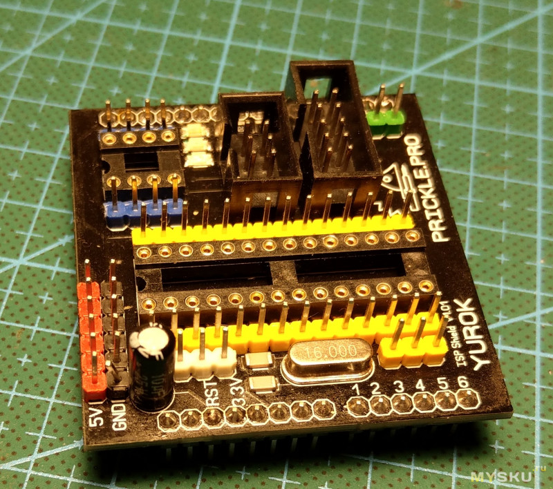

      Privetik
      Удобный шилд своими руками для ходовых контроллеров в разных корпусах. Загрузка прошивки ArduinoISP без шилда в Ардуино Uno и получение универсального мини программатора.

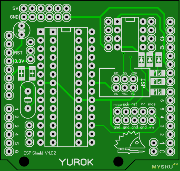

      • Plata pcb 1:1

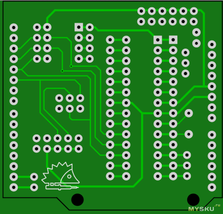

            • Hi,
              im looking for a gerber pcb of the felezjoo ? I have use this but PCBWAY say to me "it's missing drill percing".
              Do you have functional gerber file ?
              felezjoo.zip Gerber file and lay6
              thanks
              • Open whichever lay6 file in Sprint, then you can generate Gerber files including drilling info. Save in folder and send to PCB manufacturer. Remember in Sprint, you click on the boxes to select all Gerber options, including the drilling information
                Now any layout you can generate Gerber files using Sprint layout software.
                • they are right. DRL file is done wrong, check your files online http://www.gerber-viewer.com/
                  • Anyone have a right DRL file for his lay6 ? or functionnal gerber files ?
                    • Originally posted by gandolfi View Post
                      This is the easiest for home-made PCB. Why are you looking for gerber files, and you do not make your own board?
                      • I do not have the equipment to do it. I live on an island and it is complicated for the postal service to send chemicals. In addition it would cost me more material than if I order pcb in China.
                          OK!
                          Remember that in Sprint Layout6 Drill Data is displayed with a separate command: File/Export/Drill data (Exellon)
                          • thank you very much. i will send gerber files to pcbway or similar.
