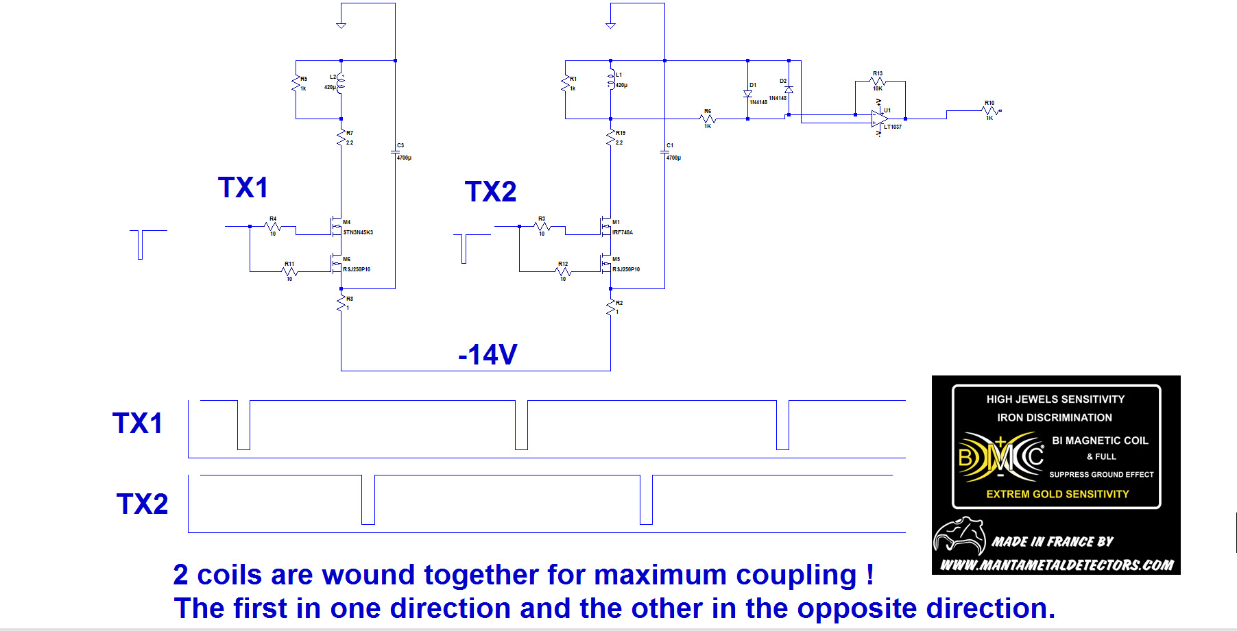

    BI - MAGNETIC - COIL TECHNOLOGY
    This will avoid the deposits of patents, I published here and elsewhere ....
    I also filed in France.
Name:	BMC TECHNOLOGY MANTAMETALDETECTORS 3.jpg

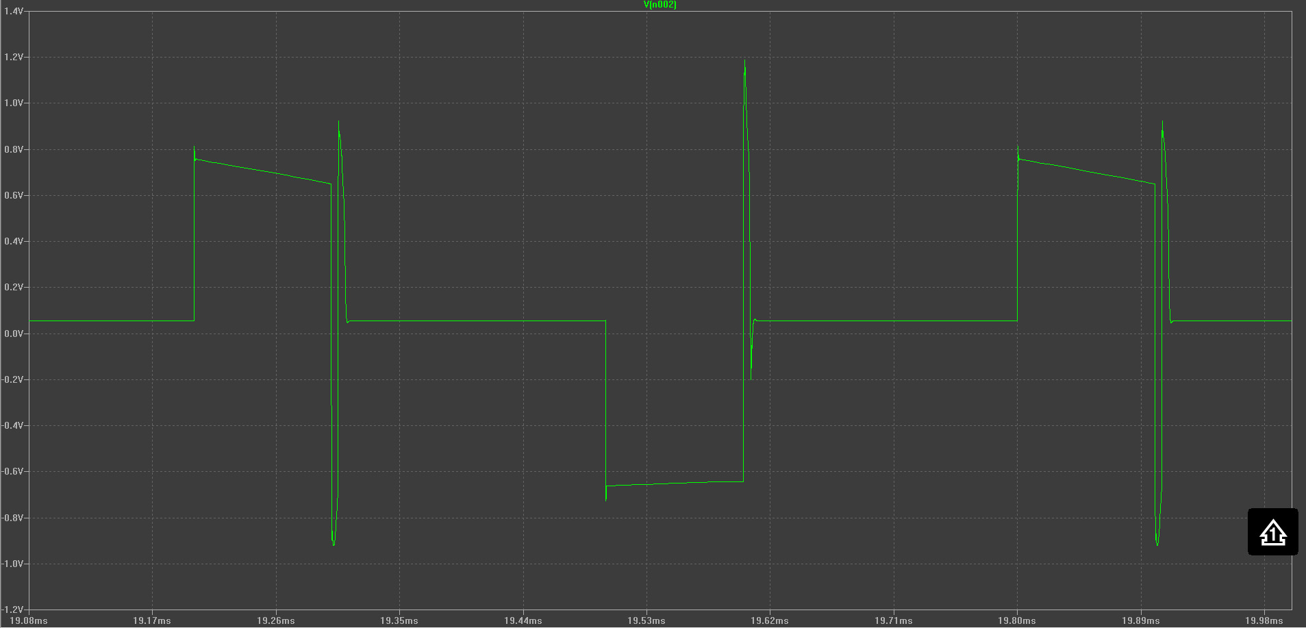

    This 2 coils are wound together for maximum coupling !
    The first in one direction and the other in the opposite direction.
    First coil sends and receives the second coil flyback
    Second coil send only and receivesthe first coil flyback (but is not analysed)
    The two coils have the resonance that armonise.
    The second mosfet cut through its diode...
    With a very good coil I can start at 6us delay (with a very good shield)
    With this system I start at 9µs ..(with a very good shield) It's nice !
    First pulse 1 = + V + GROUND EFFECT (g)
    then pulse 2 = - V + GROUND EFFECT (g)
    reception was Pulse 1 rx = + V + s or "s" is ground effect
    then Pulse 2 rx = + -V + s
    then by (pulse 1 - pulse 2) it gives + V + V + g - g = + 2V and "g" has disappeared !!

    The system works perfectly and does not alter the analysis when compared with a single coil!
    The electronic components in this schematic are not well on the components used on my product.
    This system is better than US9285496B1 Patent of CARL / Less capacitance, lower noise, best heat dissipation, faster delays, etc ....

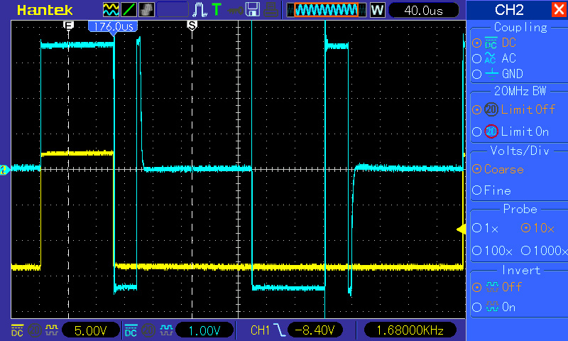

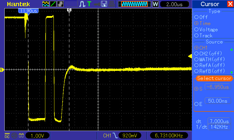

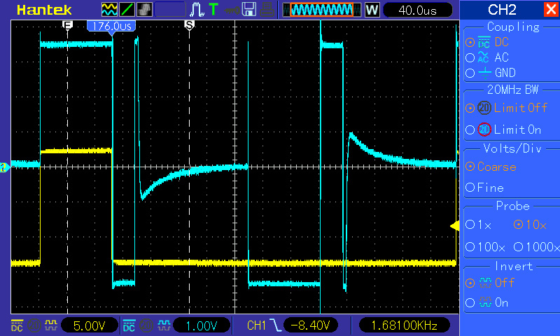

    You're focused on how to do with a coil, H-bridge, alternating current generator etc ... but the simplest solution was to return the coil and not return the current with electronic assembly !
    Oscilloscope :

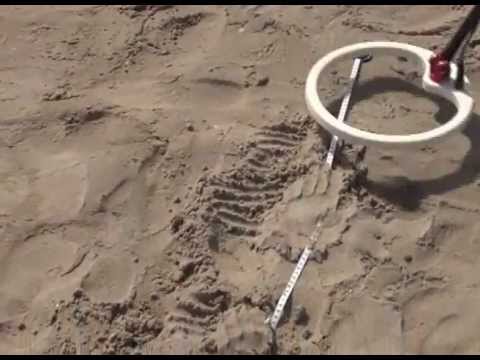

          do you have a youtube demo of your latest BMC detector ???

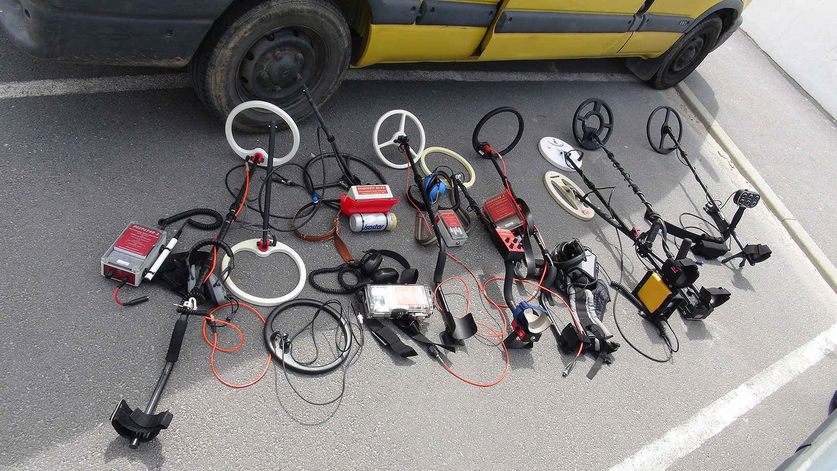

            Yes but in french and it's private youtube for the moment... Sorry, I soon publish videos for this forum.
            I also have comparative videos.
            Just a few years we did a lot of tests including the eric material for fun
