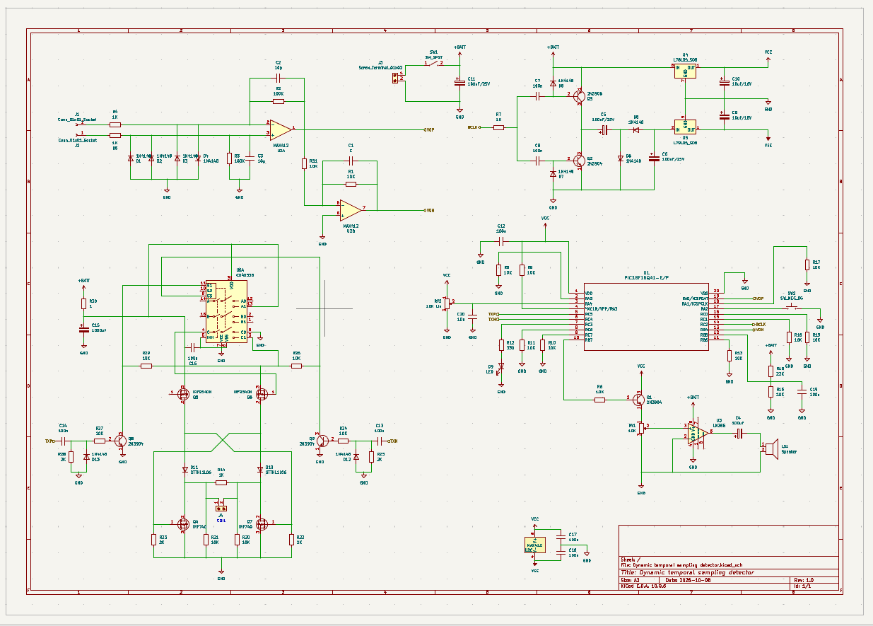

    Originally posted by BC547 View Post
    Since I don't see any external RC filter to use a PWM output as the comparator slicing level, I assume you will be using the internal DAC for this ?
    The 16F1824 only had 5 bits for the DAC level, but this PIC seems to have a programmable number of bits for the DAC output?
    Anything you can do with the internal opamp ?
    And use the NCO for audio generation ?
    Internal DAC.
    Best use case for the Internal Op-Amp: Use the internal OPA1 module as a programmable unity-gain buffer for the sensitivity potentiometer input.
    ​The NCO runs completely independently of the CPU core. The CPU runs a single line of math to convert the target into a new NCO pitch increment value. So that is very good. Maybe even implement a Bipolar VCO Tone Response.​
    Thank you for pointing out the NCO. I thought it would have to be done the old way.(timer interrupt) or external VCXO

  • dbanner
    replied
    @dbanner
    You could take a couple of late samples with the ADC of the steady state DC value of the signal.
    Then adapt the slicing level to the comparators accordingly: eg keep the slicing level a steady 0.5V lower than the "ground" level.
    Slicing voltage = 10bit PWM output + RC filter ( like in Pickini V4).
    If you want to do automatic DC level setup at startup = DC offset level of the opamps, do not use a DAC output like I did in Pickini V4.
    The DAC output only had 31 levels and switching from one level to another caused a major jump at the opamp output - to be compensated in software by a huge delay ( 1 second ) between each step.
    - Bernard
    I did a basic schematic, most of which is taken from well known Bi-Polar PI scheme. This is just for the concept (the schematic is not complete, and is missing some important parts). The initial firmware will be simple just to see if the darn thing will work at all. It belongs in a different thread though.
    Click image for larger version  Name:	dynamic temporal sampling detector.png Views:	0 Size:	166.9 KB ID:	453452
    Thanks.
