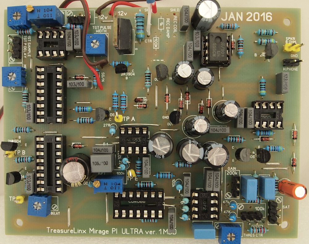

    The latest version July 2016 PCB Mirage Ultra 1 MDD, was designed to be built for a mono coil or with a few added parts can be used with a DD coil. DD coil use is still experimental.
    I have a number of extra PCB's I can offer and can have more made if needed.
    I will offer them to Geotech members at $18.00 each plus $8.00-11.00 shipping depending upon destination.
    Can also offer a component parts kit, unfortunately it takes time to put them together, so I will want $35 plus shipping.
    If you have your own sources or parts on hand, it would cost you less.
    So if there's interest, please post. This will be something I can give back to Geotech..........................Have to thank Ivonic, way back when, taking the orig. schematic and laying out the first PCB Sprint file for us. The orig. was build on a bread board. With Ivonics help went from breadboard to a real PCB. Which was revised about 12 times and that improved its overall performance
    Below is a picture of January 2016 version PCB

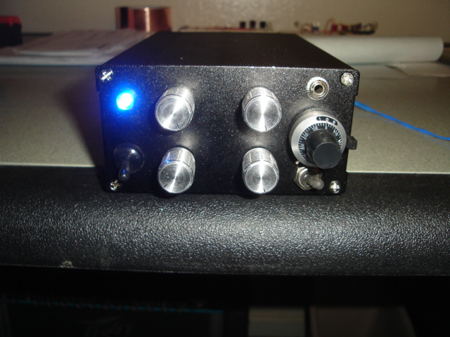

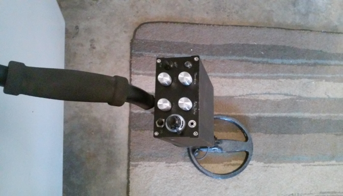

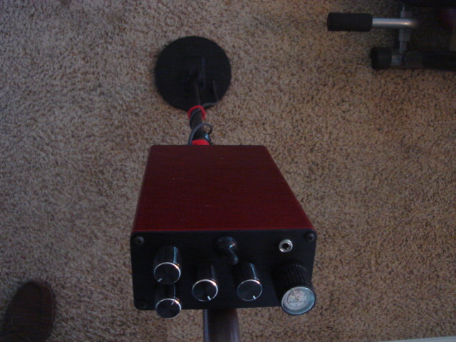

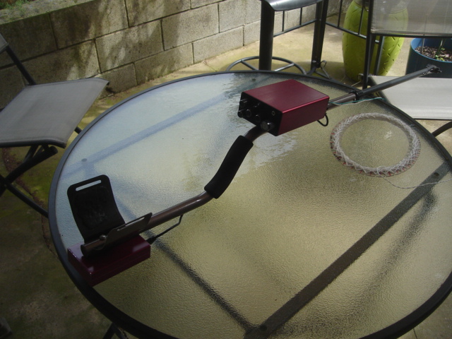

        I can attest to this being an excellent project and a nice build when finished, I have built 2 so far and both work excellent. Instruction is clear with scope shots and verbage to walk you through the build process.. A great build even for first timers or beginners.
        1st build
Name:	mirage inside.jpg
Name:	Front panel powered up.JPG
        second build
Name:	7 modified whites shaft.JPG
Name:	CBSII with 7.25 inch coil.JPG
Name:	panel layout 3.JPG

            Nice build geoscash1.
            Are those frequency buttons 10x turns? Is there an adequate reason for multi-turn frequency button?
              Hi WM6, thank you for the compliment on the builds
              Yes, they are for frequency fine tuning and are 10 turn pots. If I remember correctly (sven can correct me if I am wrong) As far as reasoning, they are so you can dial in the frequency with out over adjusting to be extremely precise, which makes the unit very stable and makes it run really smooth in the small gold or normal modes. I believe (if memory serves me) that the unit is calibrated around 1khz and can be adjusted out to 1.5khz as well so it does not interfere with the audio frequency used too.
              I set mine for use where I hunt and haven't needed to mess with them much since it works very well where I have them.

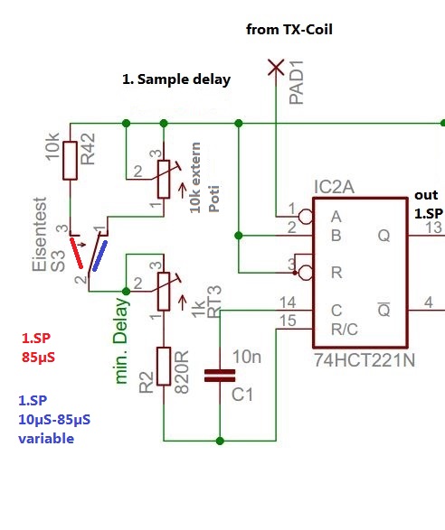

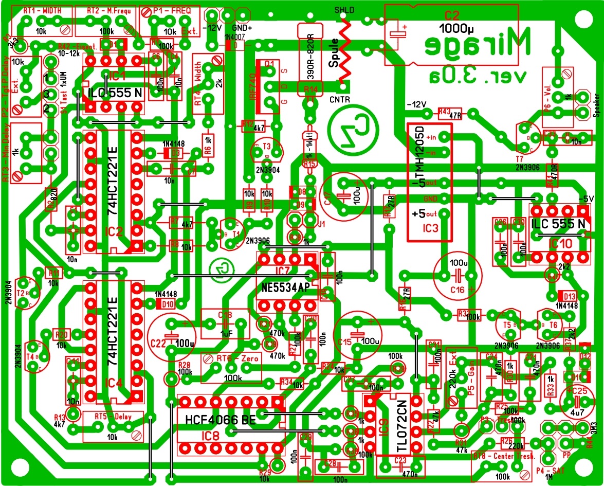

                Hi Sven,
                this is my mod. Version from your Mirage 2014.
                It has a simply Disk and a DC-DC Converter
                  Originally posted by württemberger View Post
                  Hi Sven,
                  Very Pro design.
                  With "Disk" you mean discrimination? Which part of circuit serve like this?
                  Is "Disk" genuine Sven solution or your mod?
                    It´s not realy a Disc... With my mod. you can only check if the signal
                    Ferro or Non-Ferro Metal. The Test-Button only shift the 1. Sample delay to 85µS.
                    It´s very simple, but effectiv.
                      Nice distinguish solution for small parts of nonferrous metal (with short TC).
                      For bigger parts (like say: bronze statue) it is better to discriminate by eyes.

                        The latest version has a number of PCB changes, trace changes, part value changes and part positioning.........
                        We removed the pinpoint button option. Pinpointing is fast and easy with out it, nice but feature , not needed. I rarely if ever needed to use it.
                        The iron check we talked about long ago, we didn't think it was worth the trouble or was needed but, could be added at any time. We were trying to keep
                        the panel controls to a minimum. We didn't want to end up with a detector with 100 different adjustments like the Blisstool.
                        Yes, a 10 turn frequency pot makes a big difference in tuning, at times a micro adjustment is only needed. With a 1 turn pot, its very hard for many to make such a small hair line adjustment.
