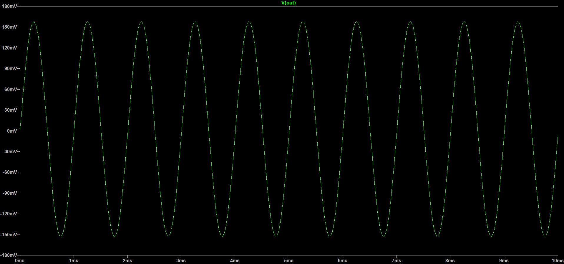

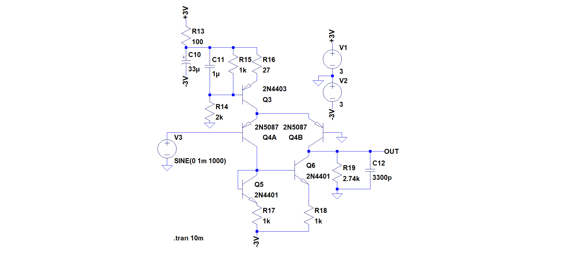

I don't believe there is. I created the circuit in LtSpice and the circuit works... It implements a low noise preamp with a gain of ~150. I had to substitute Q4 (better performance could be obtained with a better match for Q4). The circuit offset is controlled by R14.Originally posted by bklein View Postis there a schematic error with Q5/6 bases?
