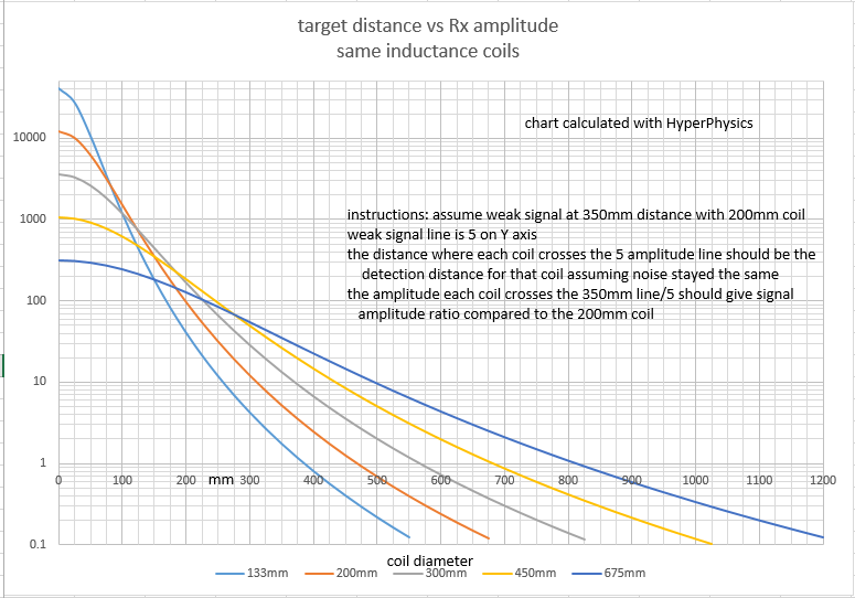

                The way I look at it. Including a chart calculated with HyperPhysics. To increase detection distance from 15cm to 30cm with a 20cm coil, S/N ratio would have to increase by 30 times. My thought, maybe not correct. Best way to get there??
