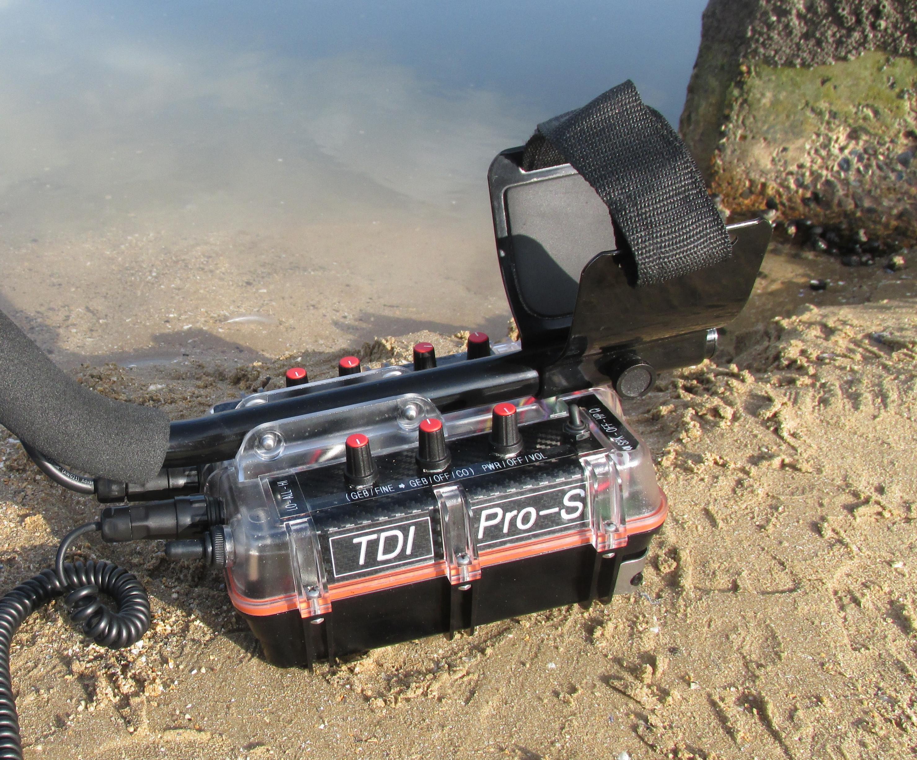

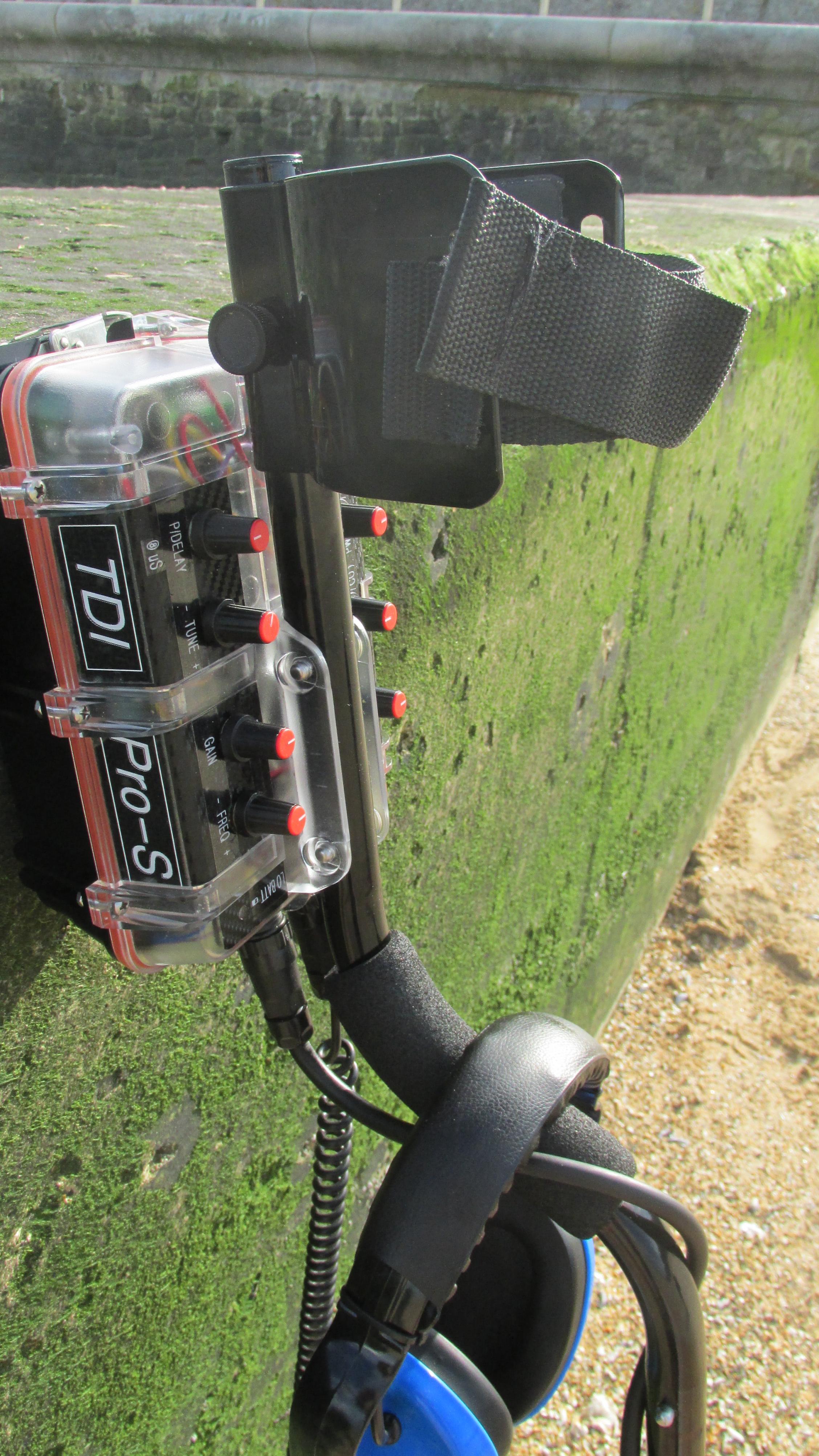

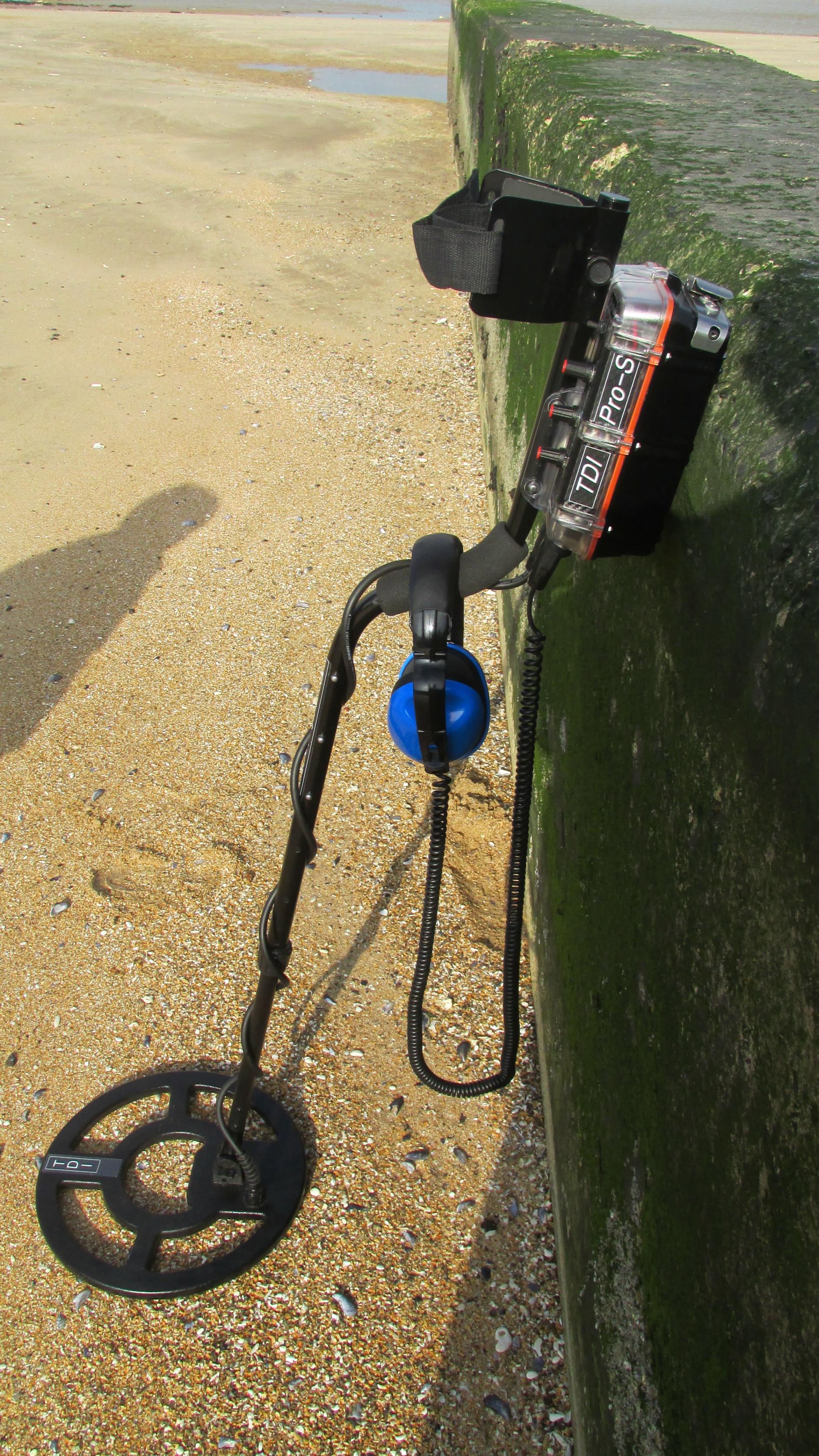

    i have just completed my second tdi pro project in a waterproof housing and modified the battery container to accept four li-ion batteries and ive managed to get the pulse delay down to 8 uS...it has taken me several months on and off to get this project up and running.

          TDI PRO Detail in studio ?
            Hi pustareka...not sure what you mean so ive included another photo showing more detail

                Hi pustareka...my project is all new and very stable...the 8 uS delay is useful for dry sand but too low for wet sand use...maybe in a few months time i will start a third tdi project with modifications for even better depth but not waterproof next time...i really like the design of GS 5/TDI....i think eric's design is the best all round pulse detector.

                          no mods on this detector apart from reducing the delay down to 8 uS....this detector is based on GS5 issue 2 and ive added all features found on the tdi pro and it runs on 14.4v li-ion.
