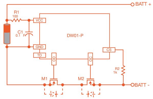

          I had a closer look at the protection circuitry pcb from battery, it contains a chip marked 2158 which appears to be a monolithic step down switch mode converter. Not sure about what it's doing or even of it's function. Maybe this isn't protecting anything.? The datasheet gives output voltage of 1.2V@1 amp.

              I had a closer look at the protection circuitry pcb from battery, it contains a chip marked 2158 which appears to be a monolithic step down switch mode converter. It's on a small pcb strip which could easily be taped on to another lithium battery.( Of comparable specs) This will protect battery from discharging below.
              I must respectfully disagree that the chip marked 2158 is a step down converter. It does not make any sense to use that chip.
              I am sure that the chip is a Voltage comparator and MOSFET switch specifically designed for Li-ion protection. There is a huge market for such a chip, millions of Li-ion batteries, so a chip with the needed functions would be designed and produced.
              Here is the typical ciruit used:
              https://www.digikey.com/en/maker/blo...ell-protection
              Are there any other parts, chips on that protection board?
              Can you please post a good photo of this protection board?

                Yes, yes, I fully agree. I jumped the gun on this one. From datasheet it doesn't make sense. Maybe isn't for protection at all. I not sure what it's function is or even if its the same chip. My camera on phone is not good enough for tiny chip. It says 2158 on the chip and is 8 legs as in datasheet I posted. There is also other 6 leg chip(3 on each side) marked 5231C. I think is small resistor array. I will investigate further.

                    I use this module https://www.ebay.com/itm/Protection-...-/323202856662
                    The board is protecting your batteries! If any one of 3 cells get under 3V, it disconnect Vout immediatelly! I was surprised, why my machine stoped working, when it happened for the first time
                    I tried to find out if is possible to change this value to 3,5V but it seems that it is internaly set :-/
                    And surprise was also... You need to apply 12V to Vout to turn it on for the first time, otherwiase it looks like its dead. Then it produce Vout until you over-discharge it.
                    • I figured out the 6 pin IC is single battery voltage protection IC like the DW01-P. The other chip could be a micro? The little circuit board also monitors battery temperature as well.(referring to little pcb I pulled out of mobile phone battery. It is definitely battery protection circuitry (PCM)

                            • Well I found out what my 8 pin chip was on my single Lithium battery PCM, it is a dual n-channel MOSFET.
                              This together with a battery protection IC is all there is.
                              Two important parameters in battery ICs are overvoltage threshold and undervoltage threshold. These numbers are the voltage levels at their limit; the IC will cut the cell out of circuit if the cell is being overcharged or over-discharged. These values are typically designed into battery protection ICs. These ICs come in a variety of threshold mixes,
                              Here is the circuit below. The same as the little board I pulled out of old phone battery.
                                That makes sense.The other chip is then the Voltage comparator and gate driver.
