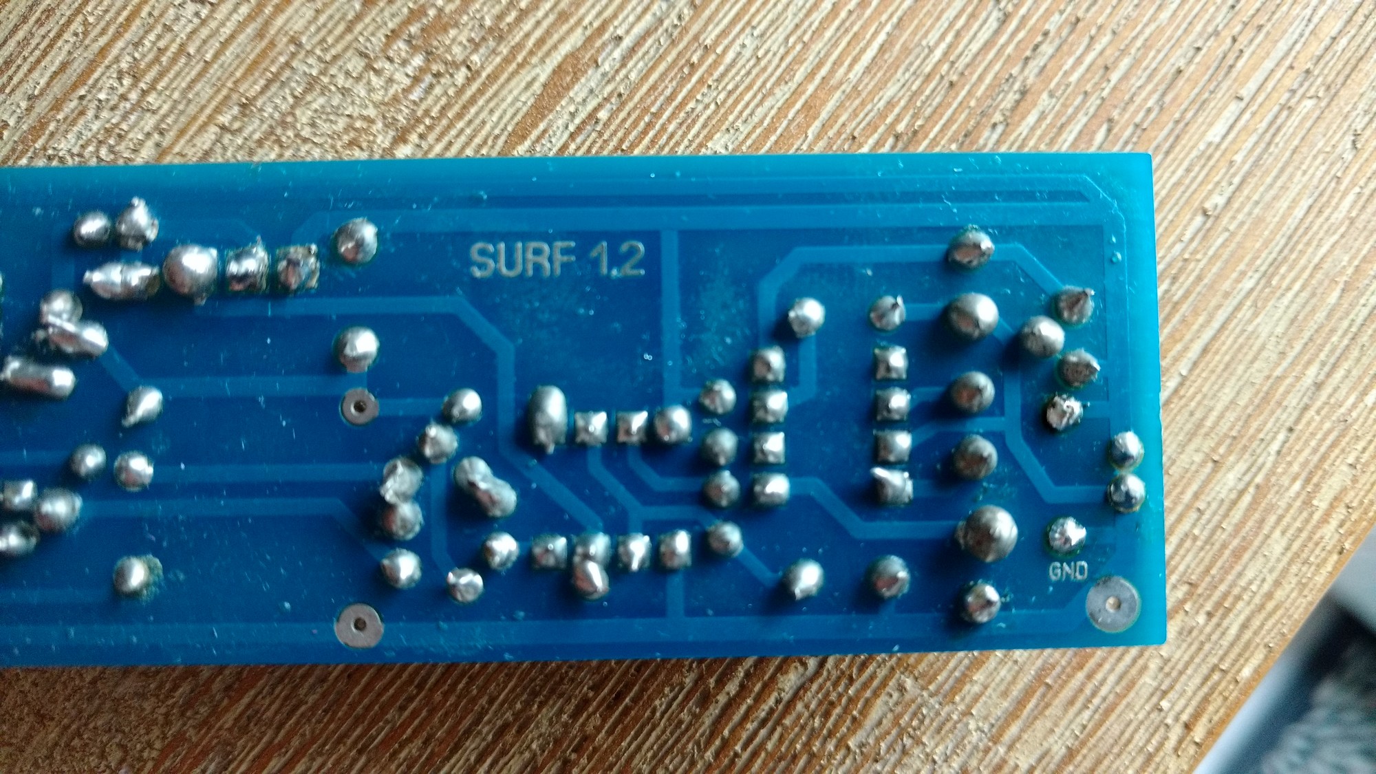

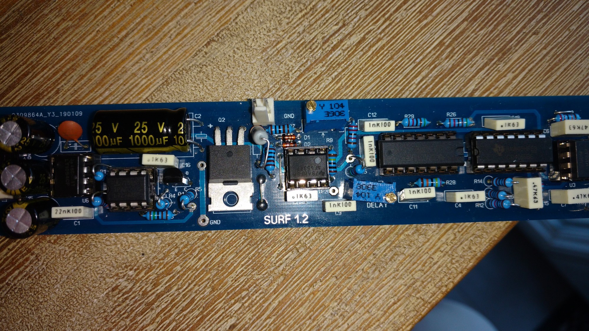

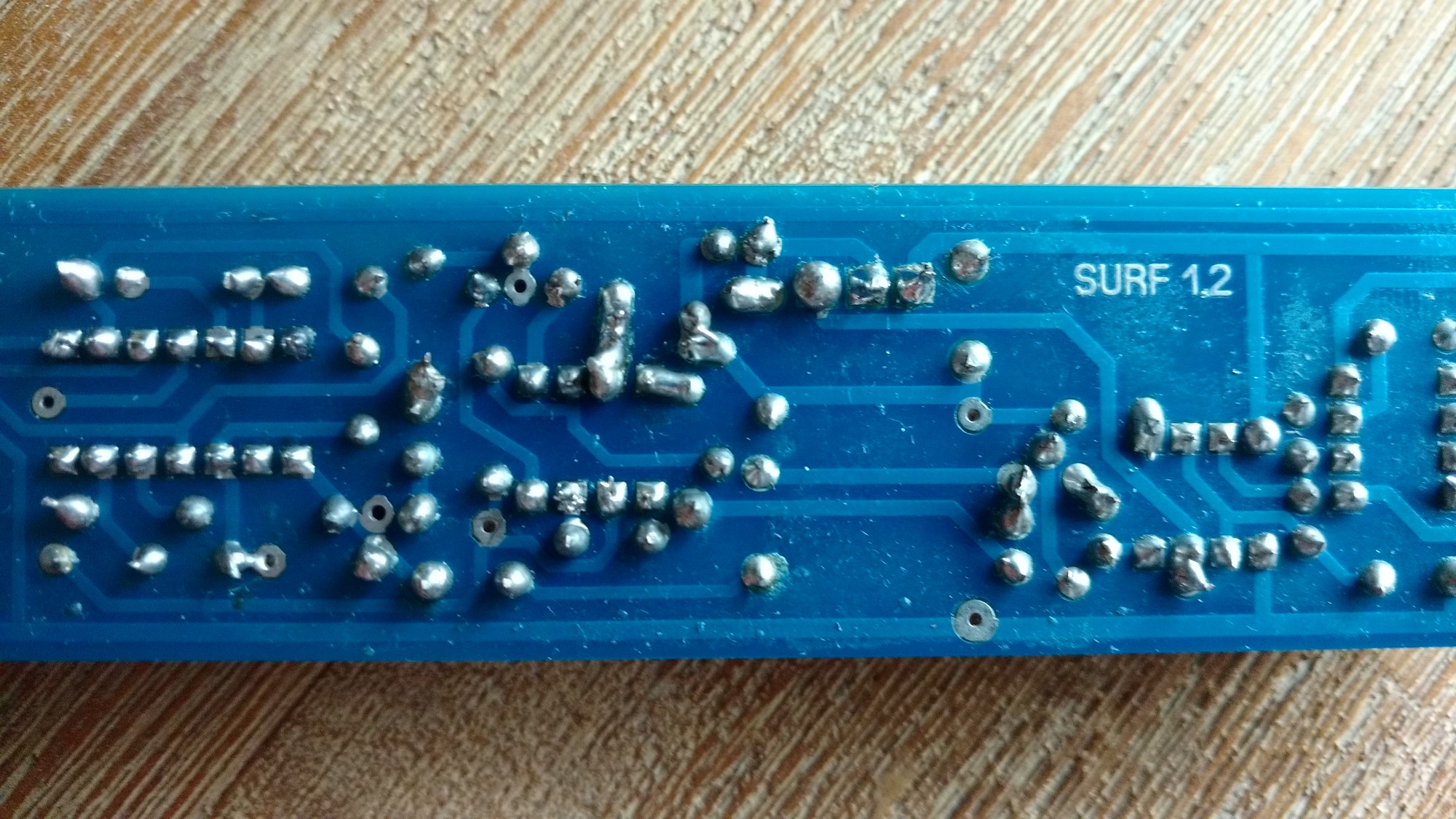

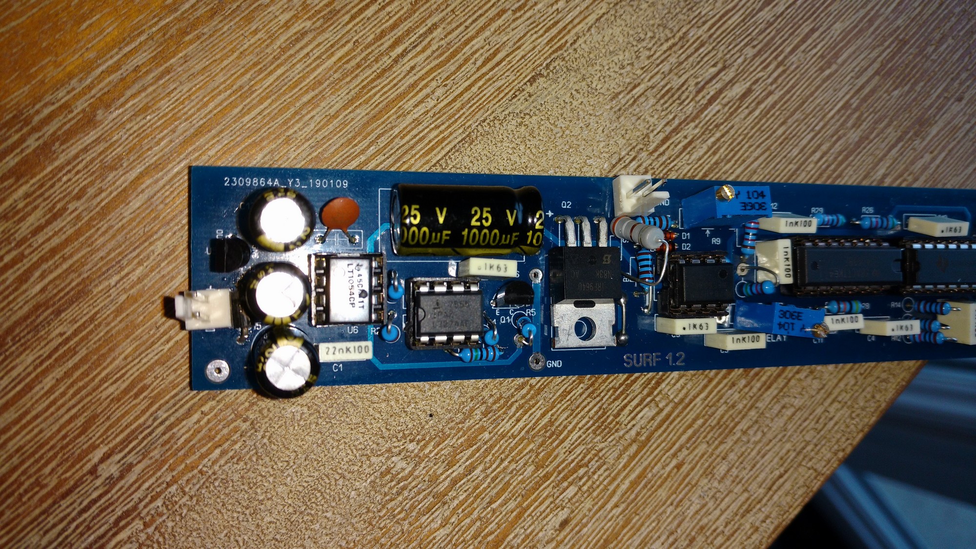

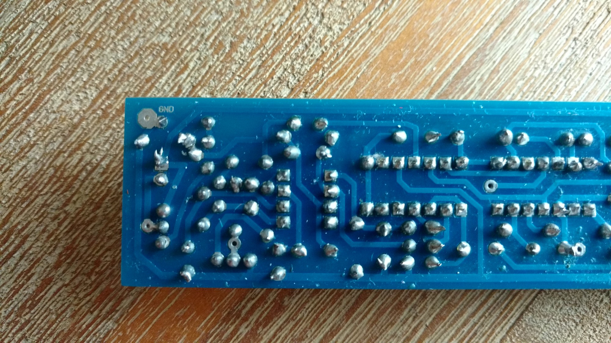

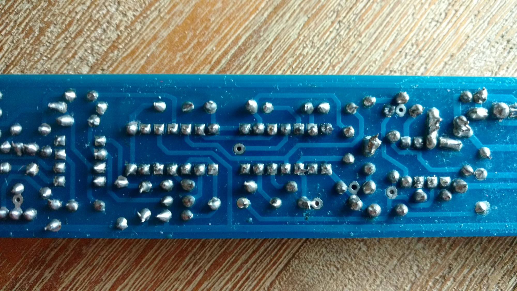

                Hello,
                Well, not better.
                I redid all the bad welds, rechecked the battery poles, changed the diode with a found (1n4004) and tested again. I roasted the diode again. I do not understand why. I send you the pictures, I really need your help.
                Thank you so much.
                Here (http://www.adrianandgenese.com/blogg...rom-a-diy-kit/) is the assembly principle with the electronic schema.
                Maybe you can find why I am so bored.
                PS : My grandmother had a pig, rabbits, chicken and cow but no horse...

                  You are just showing us the PCB. The error you are making is likely to be in the wiring to to your battery ? or Power supply ?
                  If you're using a battery, then you have no current limit, 20 Amps is possible. So insert a series resistor of 10 Ohms or 22 Ohms or whatever you can find in your debutante junk collection. Make sure it's high power.
                  If you have a voltmeter / multimeter, now is the time to use it to see why the voltages you would expect to find are not correct.
                    An even better way to current limit is put a 20-40Watt light bulb in series with the battery. An automotive tail light bulb (filament not LED) work well.
                    When using batteries that have a high current output a limiter is a MUST and will pay for itself the first time you connect something wrong and the bulb lights up preventing smoke in your circuit.
                      Remove socketed IC’s, then test the board again for current draw. Put a meter in series and tell us the current.
                        Tell us the current ? No, please don't, because the answer is clearly 5 Amps plus.
                        It seems pretty evident the power has been applied the wrong way round. Twice. He needs to seriously study his wiring to the battery.
                          Yeah you’re right. Got to have power backwards if that diode heats up.(twice eh?)
                          Don’t the instructions say to power without the IC’s first though?
                            Monamour, can you please show us where exactly you connect positive and negative of the battery? There is a capacitor near the power socket which can confuse you which is the positive. Do as Skippy tels you, show us how you connect the battery/power supply.
